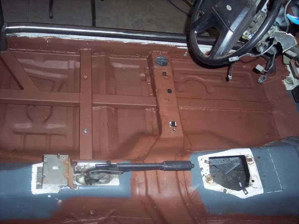

  3. Well, finally worked on somthing over the weekend besides rust repair. Feels like we're moving ahead on a modification for a change.
    Wifey kept busy with interior primer.

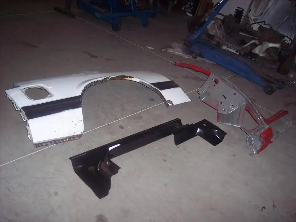

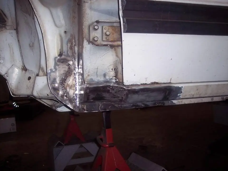

    O.K. what do you get when you cross a piece of rocker from a Dodge Dakota,a piece of quarter from an aero nose fox and a peice of quarter from a foureyed coupe? Yes, a new rocker for RUSTY...ahhhhhh

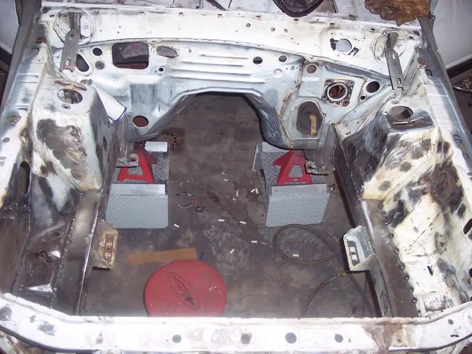

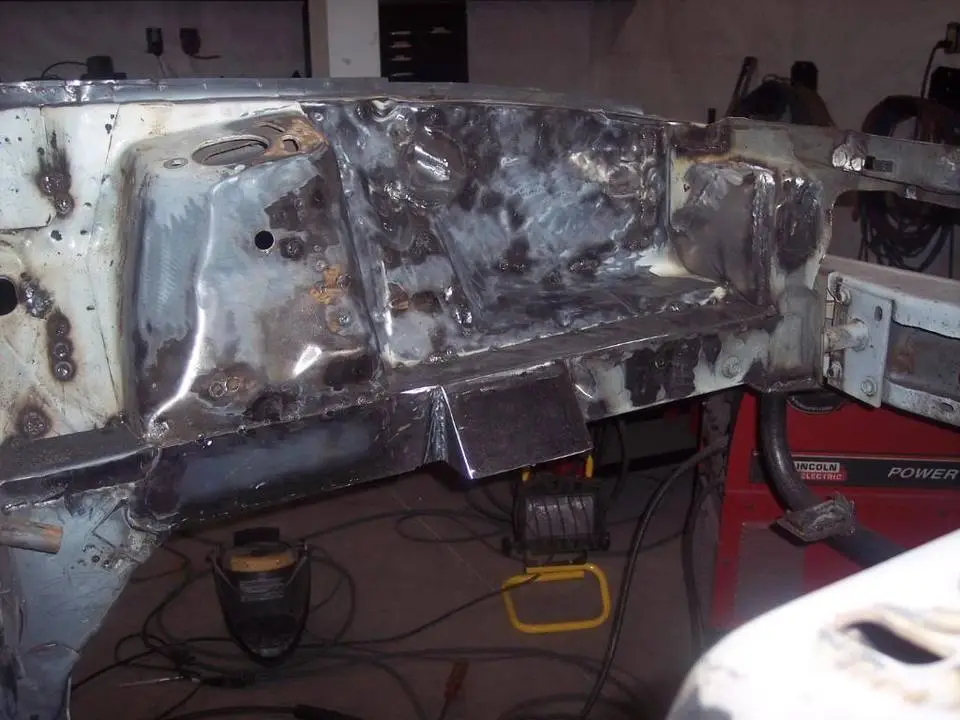

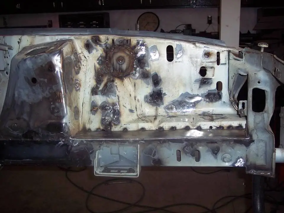

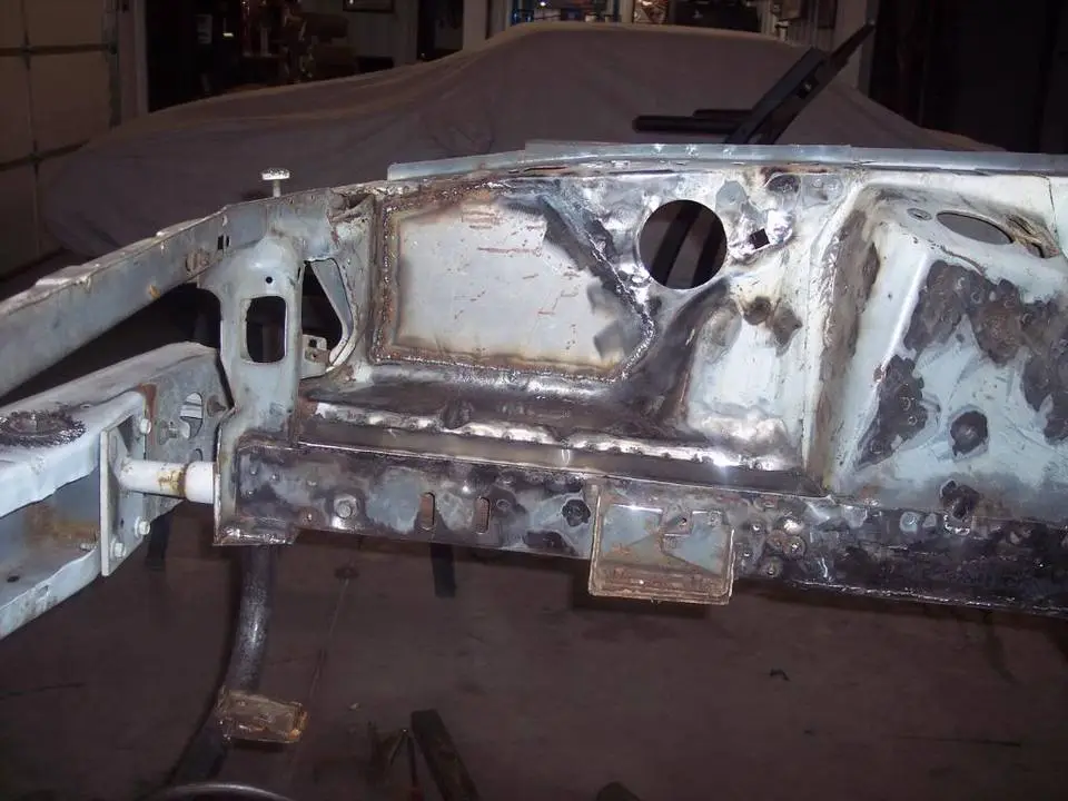

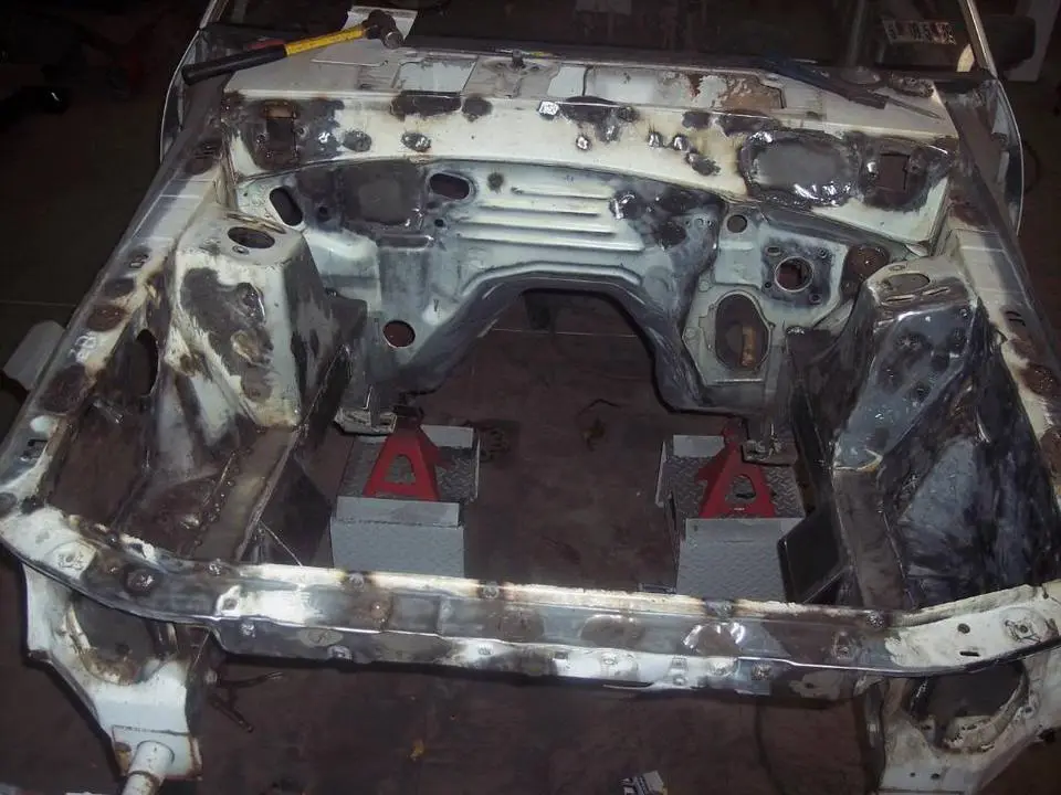

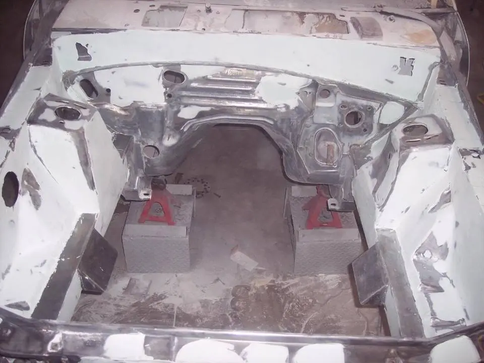

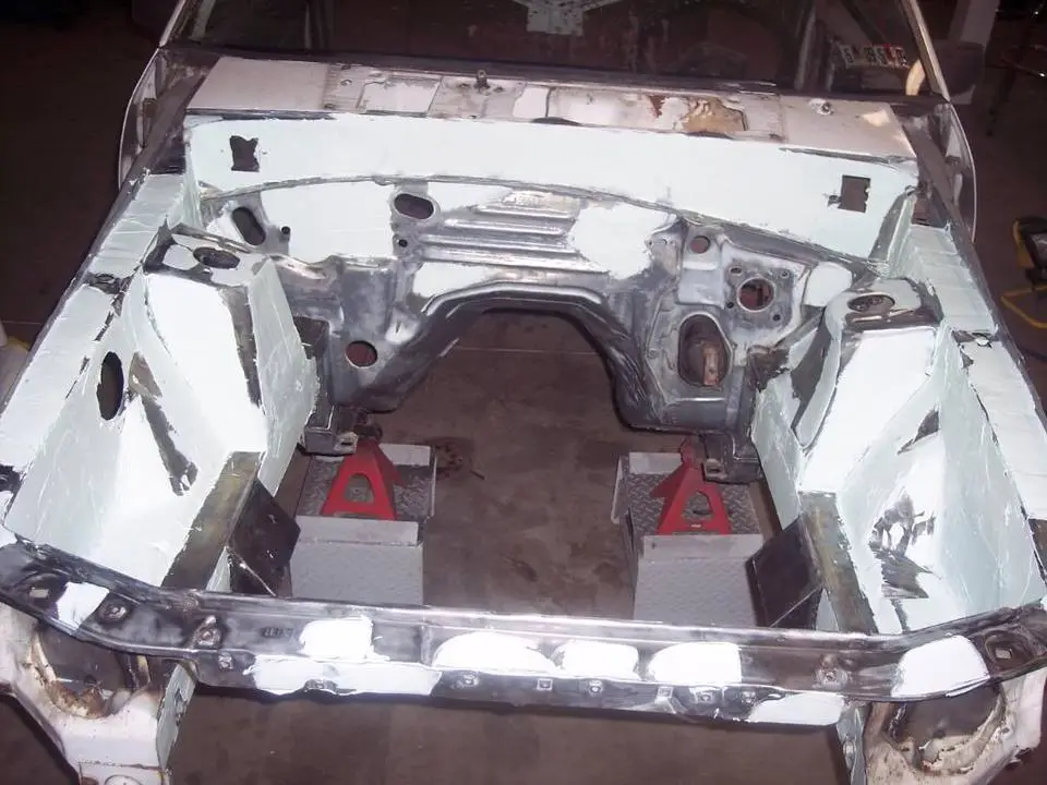

    Also got all the welding in the engine bay complete a little more grinding and on to mud.
    This is good because we really need to paint so we can tell if the color we picked is gonna be right. One hint, it probably isn't gonna be white.

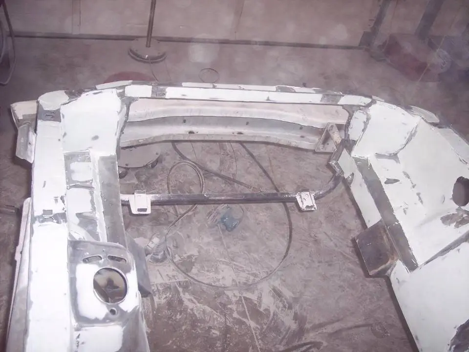

  9. Thanks Cenok. Well, we are done grinding now we're playing in the mud. Paint color is getting closer!

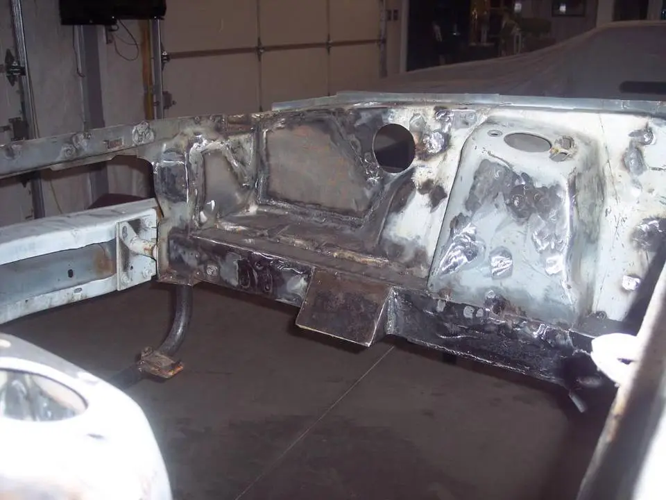

    One question, why did you leave the hole on the drivers side strut tower? Just wondering?

  16. That's where the brake lines are going through. The question should be , where are you putting the windshield wiper motor?:D
