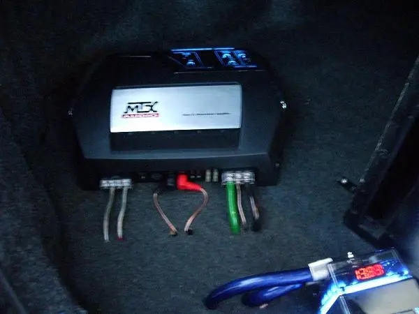

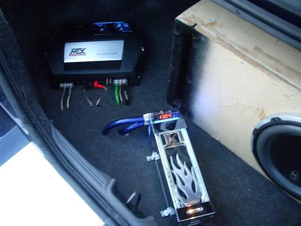

If you really wanna flushmount them then go ahead. It would b easier and cheaper to do a nice setup w/o flush mounted. Heres my set up. I just need to carpet my box.

i just dont really want a box that might be able to move around the trunk. i love to get out and go slinging every once in a while and the idea of a 50lb box sliding around my trunk isnt that great! do you have any trouble with the trunk ratteling? i guess dynamat would fix it if so
