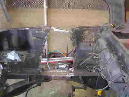

    I wish my parents were cool enough to name me cobra jet. But no, just chris. Its an F code but I was going to buy a 351C for it. The shock towers are new from NPD so they better not have any cracks.
    EDIT: I was looking at the global west site and they said you dont need a rear sway bar with their leaf springs and some kind of bushing they offer? Any thoughts? :nice:
