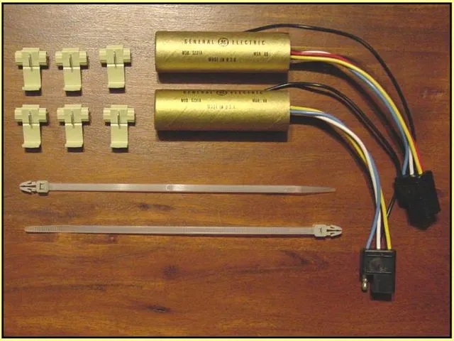

    These guys (Mustang II Tech) have a nice article on making a set of sequential taillights for the MII.
    You'll probably want to look up the MII "3 red tailight" modification also.

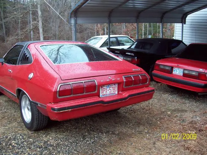

    taillights all red
    here is a rear shot of my moded taillights, got sequentials in them too.
