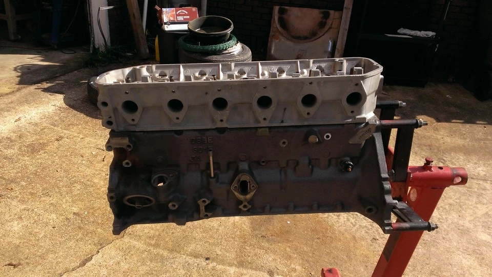

    This is a surprise, a cross flow straight 6 head! I do not know why more were not that way. There should be some good performance gains there. Pontiac's tech 4 was a fun little motor with the cross flow head and this has two moe pistons. I know most of these were made for truck torque, but port design and heat transfer are so much better on a cross flow head. Too bad about the mods to make it work.

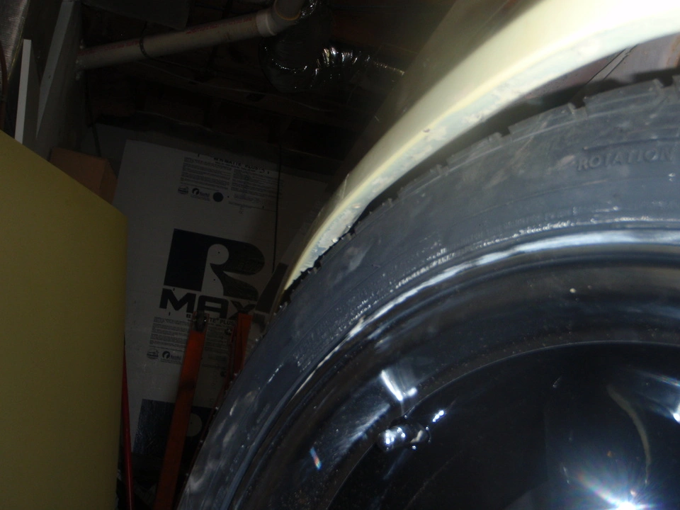

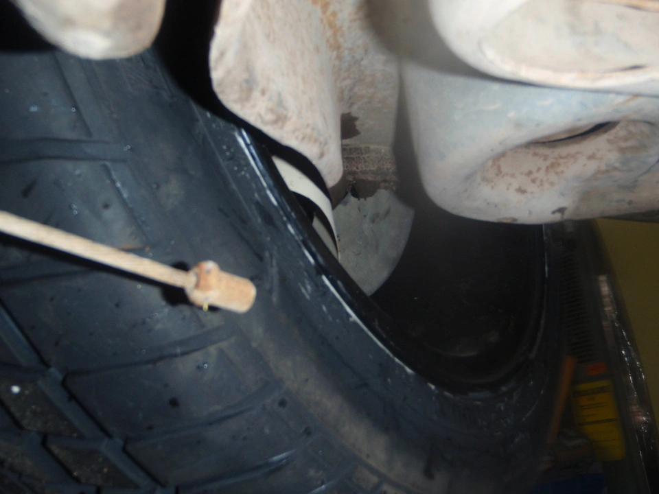

    More of the same,....a whole day spent,..little of nothing done.

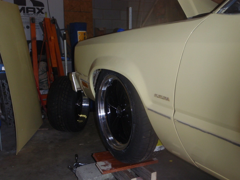

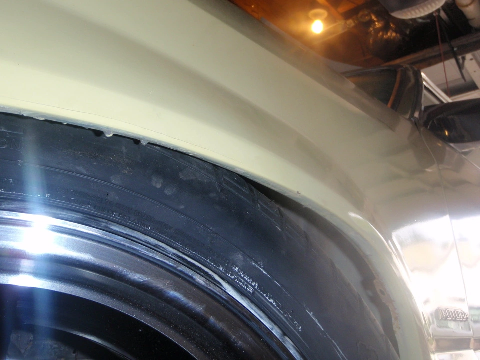

    I started out w/ the goal of determining whether or not a 255/40/17, mounted on a 17x9 rim will fit on the front of the car.
    Initially,...it didn't.......till I tugged on the fender lip:
    With the ride height set to where I think I want it, in a bass-ackward kind of method,...It fits
    Uhhh.....that is till you turn the wheel:
    Crash!
    Crash!
    Crash!
    It doesn't matter which way you turn,..the tire makes contact everywhere. It will hit the fender lip, the rim will hit the lower control arm, I just don't see how I can keep a tire/rim this size on the car, and not have to baby it through turns.
    It's been suggested that I bail on the 17x9/255 front wheels,..and fall back to a 17 x8/245.... but I cannot return them since I now have bolted the one on,....and even if I could, I'm sure the freight would be a killer.

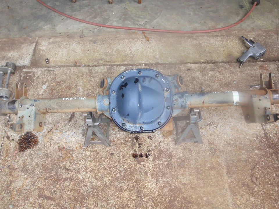

    I shelved the front tire dilemma,...and moved to the rear end.

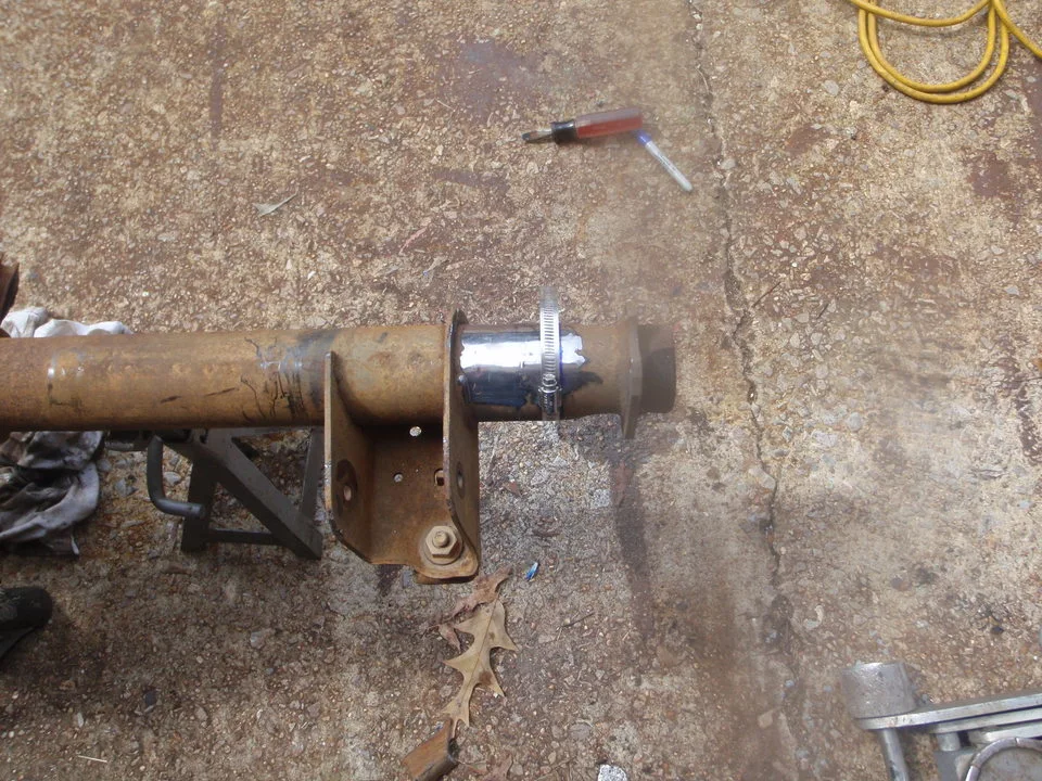

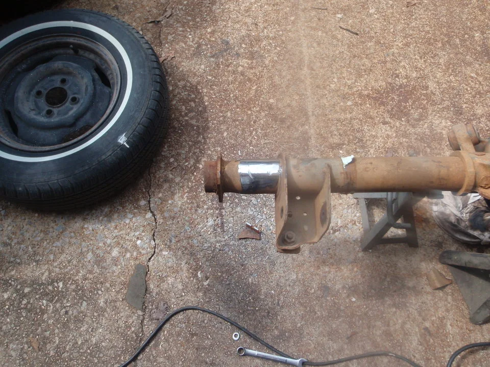

    Again,....I was "advised" by another to set the rear tires at full bump before I measured the space between mounting surfaces to transpose to the rear end. Doing that required I move the tires in another 1/4" each side. The new total rear end length had to be 57.5",....the rear end was 61.125",.... 3-5/8" too long. I needed to cut 1.750" off of each tube.

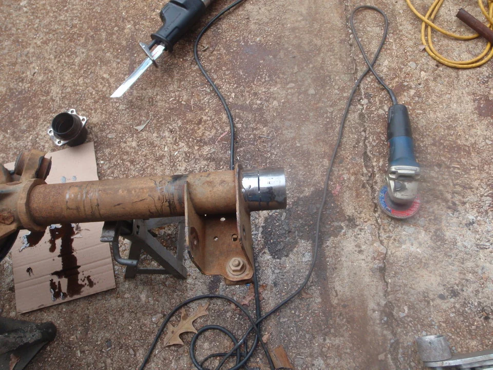

    I stripped the thing of it's brakes and axles,...and started cutting off the quad shock mounts.
    A sawzall is my weapon of choice,...cutting the quad shock mount into little pieces until I got it down to a grind-able nub. Once there,...I smoothed the tube w/ a flap wheel.
    To make the first reference cut,...I got a big-assed hose clamp and put it on the tube, using the axle flange as a measure reference to square the clamp up.
    I outlined the clamp w/ a sharpie,....and used a 4.5" cutoff wheel to cut it off.
    I originally started using a sawzall to do this,..but it is too hard to keep a precise cut,..so I just used the cutoff wheel to do it....once it was gone,...I moved the clamp over 1.750" traced it,..and cut it off as well.
    It was at this juncture, that I have to call in the pro's,...as now that the housing was narrowed,...I didn't have a housing jig to put the thing back together. I loaded the thing up, and went to his shop. The process required that I knock out the bearings out of the housing ends,...and remove the diff. He had several different aluminum "donuts" to support the tube in the housing,...using the bearing caps after the diff was removed.
    Doing it this way serves as a testament to what kind of life the rear end saw from it's previous owners,...as the tubes will bend in almost all 8.8's depending on how abused they were. Having that big bar running through the donuts makes it very obvious, real quick as the housing end will not line up w/ the tube.
    On one side,..( the driver side) the tube was barely offset,..and after welding, imperceptable. The Passenger side,...the launch side,...the side that digs the hardest when you side step the clutch,...well that's a little different.
    My passenger side axle was bent enough to require the housing end be welded a little under an 1/8th offset. Looking at it before welding looks like it's Phucked up as a rats' ass,...but again,..after welding,...not so bad.
    The pictures of all of the above?....sorry, forgot my camera when I left for the shop.
    I guess all this crap was ordained from the beginning.......as it was fate that I had to open the rear end to remove the diff, and reveal to me that the 3.73 gear I thought I had was off a little.
    It wasn't a 3.73,...it was a 2.73 that is in this rear,...another unexpected 500.00.
    I left the rear at his shop,..and I gotta order 3.55's,...new bearings,...and send the axle to Moser for shortening, resplining,..and cut for C-clips.:dammit:

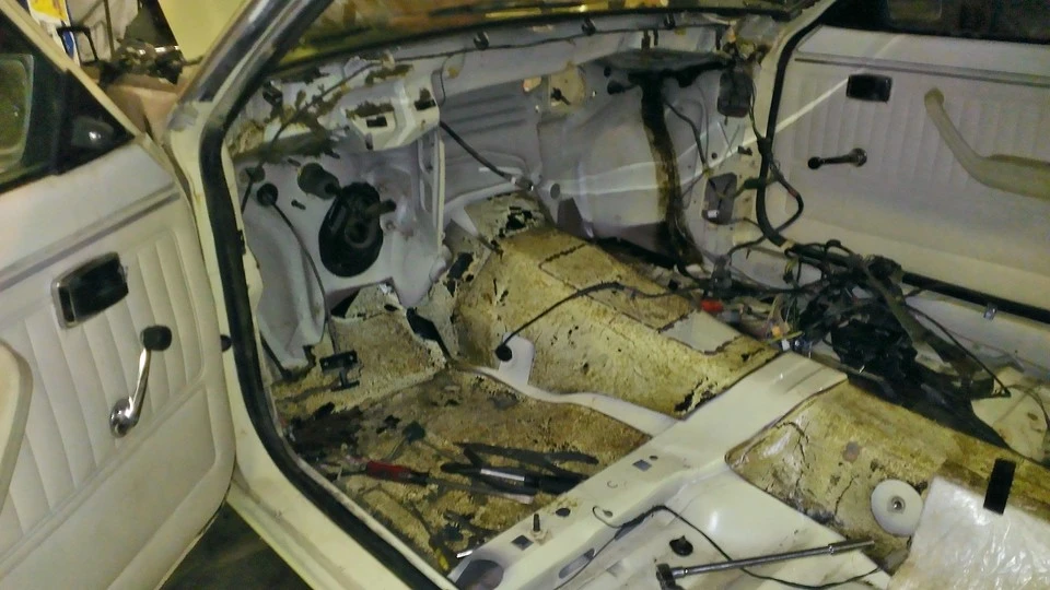

    After spending all my disposable money this morning,...I went down stairs,..and removed the driver side fender. The purpose to make it easier to clean and paint the inner wheel well prior to adding the new spindle, coil over struts, bump steer kit, Cobra brakes and rotors.

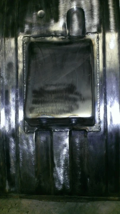

    Once one fender was off, I bounced around to removing the dash,..wiring,..and the firewall blanket. My logic there being the conversion to a '90 dash, and console.
    I'm gonna weld up the holes in the firewall where the heater hose, and A/C lines originally stuck through.
    I'm gonna try to use -10 bulkhead fittings ( for the heater) relocated over to the passenger side recess behind the kick panel, and a -6/-10 A/C bulkhead in the same area to allow the lines to run under the passenger fender.

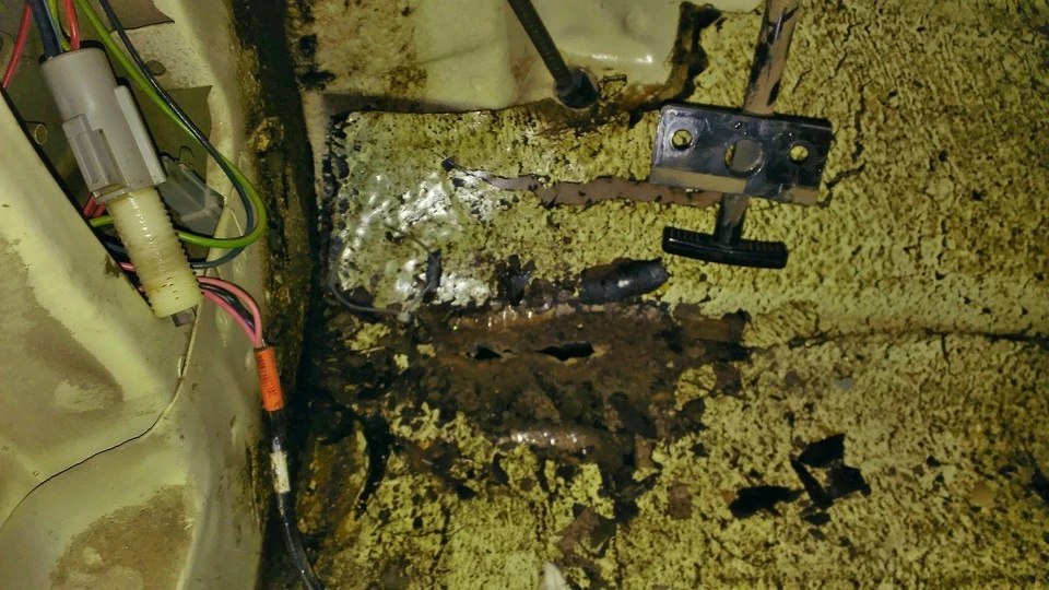

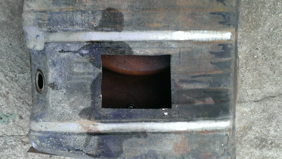

    I was looking at how perfect the floors were,..when I noticed what looked like rust on the driver side footwell,.....sure enough,...however it happened,...I got this blemish on an otherwise perfect floor.
    It's not bad,..it will have to be cut out and patched,...I just don't see how that area managed to rust through.:dammit:

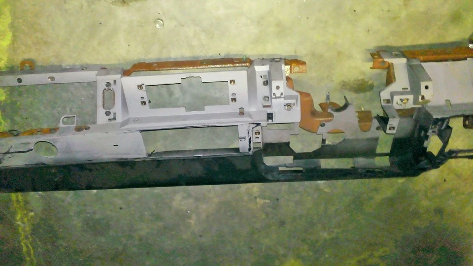

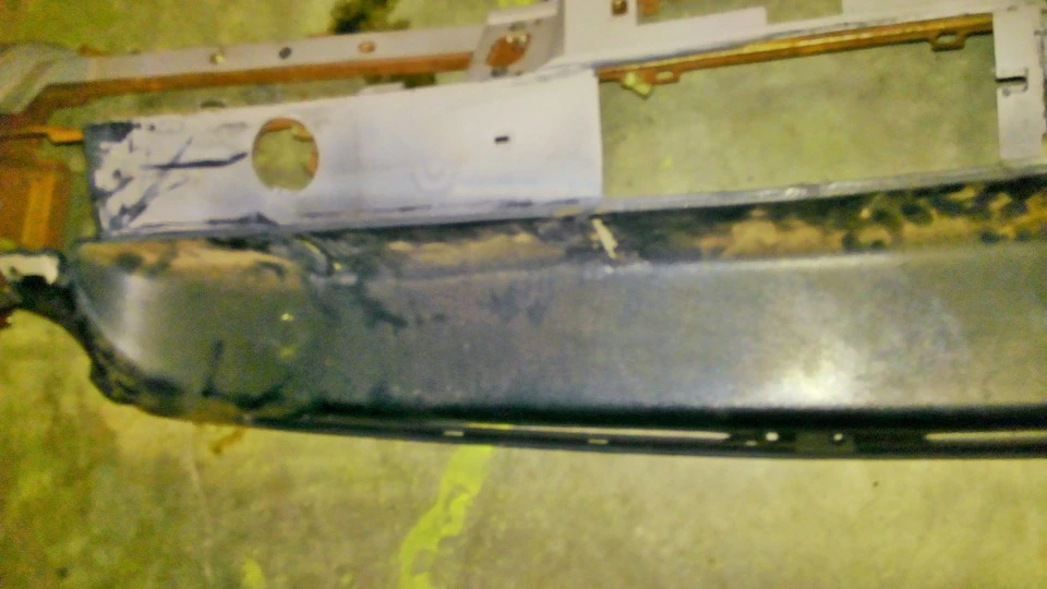

    Not wanting to deal w/ that just yet,..I again bounced over to the dash:
    Imagine the dash base w/o the gauge cluster looking the same all the way across. Same recess, same curvature,..just consistent all the way across.
    I'm gonna do that.
    It does require you butcher up a perfectly good '90 dash to pull it off though,.....but,....I'm that guy.
    (Junky, stupid camera phone .......supposed to be a 8MP camera,...sometimes the pictures just look like ass):nonono:
    What these "pictures" are supposed to show,...is the start of the path of no return. The little retaining areas that allow you to secure the gauge pod?.....gone. The little ridges on top of the passenger side of the dash?.....gone. The A/C vents at each end of the dash?....gone.
    I plan to have a piece of 1/8 alumimum brushed as wide as the stock dash pad running all the way across from one A/C vent to the other. The face of the dash behind the dash pad is concave, so I plan to come up w/ some sort of base sub structure that'll be flat to mount that aluminum on top of. The Digital gauge panel only requires a 1" thick depth,..so,..when complete,....the gauge panel will be integrated into the aluminum band that runs across. Right now,..an idea still in my head,...but it will be very close to what I'm trying to describe.
    So all in all,...a bunch of piddling around,...all taking me in a backwards direction. I'm gonna pull the engine and trans,..and clean and paint the engine compartment, and clean those two nasties up before I reinstall them for the time being.

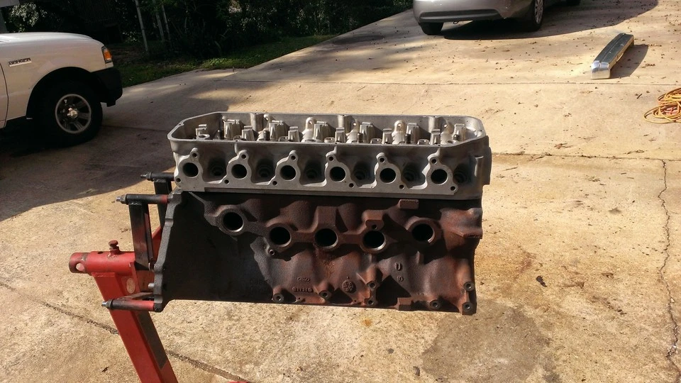

    Bought the Megasquirt today.......again.:nonono: I bought the same MSII w/ a 3.0 board that I had the last time,..and the "stimulator" to test the circuits as I go along.
    That got me thinking ( hence the revision)
    I'm gonna move the 250/crossflow head build to standby mode. That engine would be port fuel injected from the get go.
    I would use the same MSII to fuel it, and control timing that I bought today,..but here's the rub:
    The engine will have either a flat tappet solid, or hydraulic camshaft in it. ( No hydraulic roller cam option available for these crotchedy assed engines) The camshaft for the Ausie headed 250 HAS to come from Austrailia. Old school camshafts require a break-in of between 2000-2500 RPM for like the first 20 minutes after first start up. Having a home built, F.I. ECU as the primary controller, w/o the benefit of a proven fuel/spark map running the engine for the camshaft break-in is just more stress than I want to deal with today.
    So the "modification" to my plan is to modify the stock cast iron head like I originally planned to, which involves cutting away the cast on iron intake, and exhaust manifolds, (which I just got through doing) hand fabricating tubular steel pieces for both the intake, and exhaust,..and transplanting the modified head onto the stock, running 3.3L currently in the car. I'll get the fuel curve and spark maps perfect using that engine as my guinea pig. After I get that done, I'll turbocharge that combo, and set the boost down to like 8-9 psi, and drive it till I get the 250 ready to go.
    (or until it blows up, whichever comes first)
    At least that way,..I'll be able to trust that when I start the 250 I can transplant the stock injectors off the guinea pig, set the RPM where it needs to be, and let it run for the cam break-in period, w/o worrying about wiping it out.

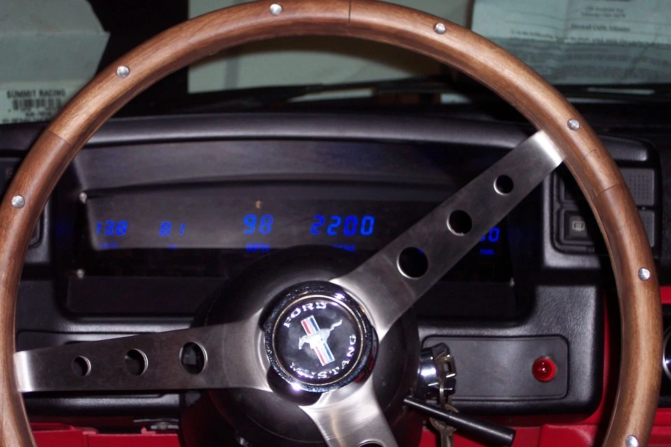

    I also bought my digital gauge panel today as well. 6 digital gauges including a calibrate-able speedo, a tach, oil press, water temp, and voltmeter all w/ senders, with turn signal, and high beam indicators, for the bargain price of 266.00.

    Why wait? They look exactly like this only red.
    I'm sorry that I don't have an extra 800.00 like I did the last time I installed a set of "American" gauges to keep you happy . I can't tell you who makes them,..they're summit branded, I do know that I'll be able to buy my transmission with the difference saved .

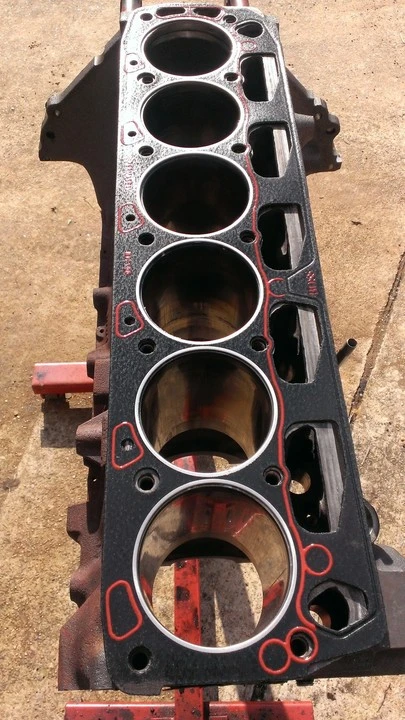

    Went and dropped off the cast iron head now that I hacked away all of the old cast on manifolds. I went from there to my friends' shop where the rear end was. I cleaned up the old diff, while he removed the pinion from the housing. I pressed off the pinion bearing,...effectively ending my participation in the set up of the new 3.55's
    He did the rest.
    It went together using the same shims that were used with the 2.73's from the factory. He said I was "lucky".

    All in all he welded the housing ends on for me using his jig, and set the gears up. It cost me 100.00.
    (Now I felt lucky)

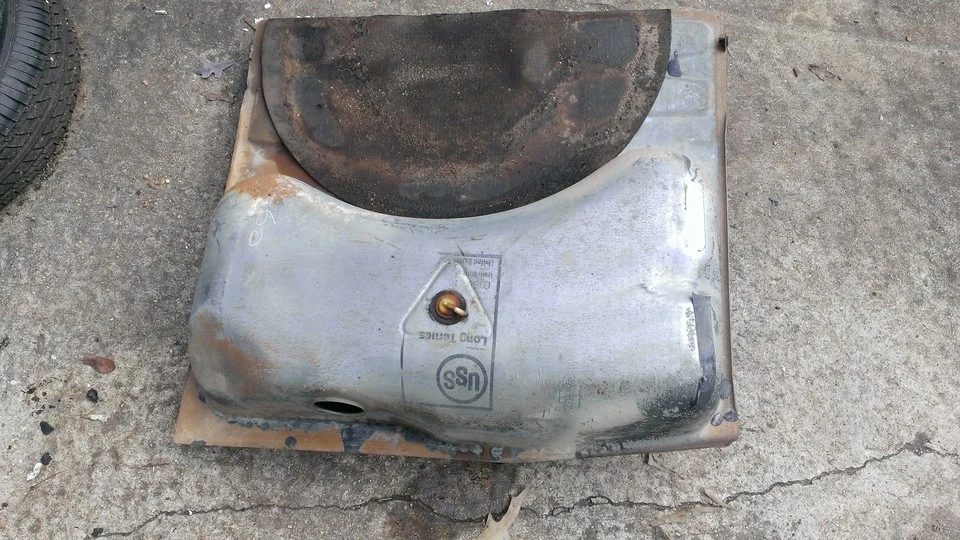

    I loaded it up and went home, where the gauges, and fuel tank sump were waiting.
    I pulled my tank out of front of the garage and started to flush it out.
    The instructions for the sump wanted me to drill (5) 2" holes to allow the gas to enter the sump,..I decided that would be more hassle than what it was worth. I left some water in the tank, marked a cut out hole at the lowest part of the tank, and cut it out.
    Now, with all the talk about welding a gas tank, and the dangers involved you'd think I have a problem using a cut off wheel to do the job, with all the associated sparks that come with using it.
    Naaah.
    Once I opened it up, it was all too obvious that the thing was full of rust. I decided that I would use some muriatic acid to see how bad it was. Problem was I didn't have any.
    I didn't want to go all the way to damn Home depot, so on the off chance that this little weird ass convenience store down the road would have some, I went there instead. This little store looks like your average gas-n-go, ran by your typical middle eastern dude, except there is a buttload of hardware related junk in the basement.
    I know this because of an earlier encounter w/ this guy a couple of years ago when he informed me of the hardware store in the basement.
    So I ask dude if he has any muriatic acid.
    "What ees mooriattic aceed"? "How you use?"
    "Muriatic acid is used to clean concrete, all hardware stores have it" I tell him.
    "You come down, see eef we have what you need" Ahnwar motioned me down stairs.
    I follow this guy down this dark stair case,...faintly in the background I think I hear "It puts the lotion on its' skin"
    He turns on a light,.... "You see"?
    There it was right in front of us. It had been there so long it was leaking. I had stumbled into my very own little chemical waste dump. I said "there it is. " and pointed to the leaking bottle. He says "Good, I make you deal". "No dude, I can't use that bottle, it's leaking,..I have no way to store that". There was another bottle right next to it that wasn't however. I took that one instead.
    He still made me a deal. $6.00 for the gal.
    I went back home. and poured that stuff into my rusty ass tank.
    One hour later, via a regime of sloshing, sanding, scraping, rinsing, and repeating,...I had the inside clean enough to move forward.
    I welded.
    This was some of the easiest welding I have done in a long time. It really welded up nicely. I didn't check to see if I had any leaks,..it wont matter if I do,..cause I'll use the same Red Kote gas tank sealer I used in the last car. I went ahead, and cleaned up the outside a little,...it was getting dark, and I didn't spend too much time. I'll finish it up later.
    stangboy likes this.

    Its a lot more fun lighting up the old residue inside. Nice work though Clarice, glad you didnt set yourself on fire like your old sig guy.

    Is that a 10 gallon tank? It looks pretty small.

    Have you seen the metallic brown colors that Mercedes and BMW have offered on their cars for the past couple of model years? I've seen a few in person; they're really nice colors.
    The Mercedes color is called Peridot Brown in Germany (not sure what it's called in the states).
    The BMW color is called Marrakesh Brown in Germany (also not sure what it's called in the states).

    Of course it is,.....what else IS there to do in Iowa except see if you can't blow yourself up.
    I had absolutely no concern as to setting myself on fire,...I wasn't the one trying to make a Molotov cocktail out of my old tank.;)
    What are you asking me to do? I offer this junk up voluntarily.:nice:
    I like it,.....I'd be concerned that I'd have to pay a premium because of the BMW/MB usage of the color though.
