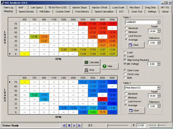

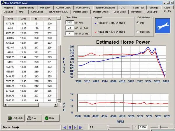

    Let me start with you Grady first of all :hail2: :hail2: , you were so right about the WB going nuts. a simple recalibration made the trick.
    I did a run just about 10 minutes. ago and my WB readings now look sooo much stable and fine. that i really thank i first try recalibrating and doing a run and read the logs and the WB. if i would leaned the mixture more i would be right now crying a dead engine.
    But more than being sad I am more happy than ever , finally my WOT AFR is 12.8-13.2 on all the curve from 1500 rpms up to 6000 rpms, i call it the perfect tune as to say right now.
    And of course all the CL operation is so smooth at 14.7 that is unbelievable, and the karmfs sitting right where they belong 1.003-.9998
    Thanks to all that read my post and i am sorry again.
    Now i have a little more tweaks to do since i did some leaning the lambse shows 11.8 as stock but the AFR is at 13.2 so this should be solved with some MAF transfer fine tuning (enriching) and just set my fuel table to the right settings.
    Thanks again to all , and Grady :hail2:
    Please allow me to show this two beautiful EA output screen shots.
    I dont know if the E.A. HP/TQ calcs are really fine but they sound more or less realistic and if you are thinking that that HP is low for a h/c/i let me tell you it may sound low but i am at 7000 ft+ of altitude so i think they are fine. :drool:

    WOW- its been awhile since I downloaded an update for the EA program...it looks alot better (and it is a good program version I have).
