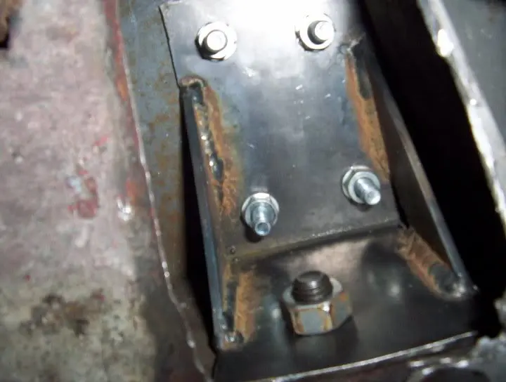

heres some pics that may help ya. i made my own but they are pretty cheap to buy
