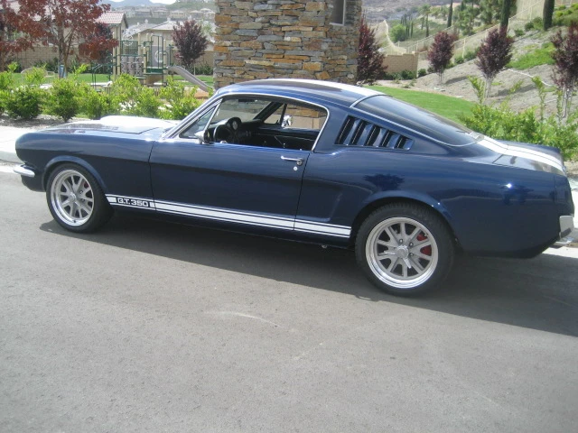

    This is the closest to the 427s that I could find, they're Vintage wheel's 60s
    [IMG]

    I know the AR Cobra 427s will be a little different, but now that I see that rim on a classic stang, it just doesn't do it for me. :(

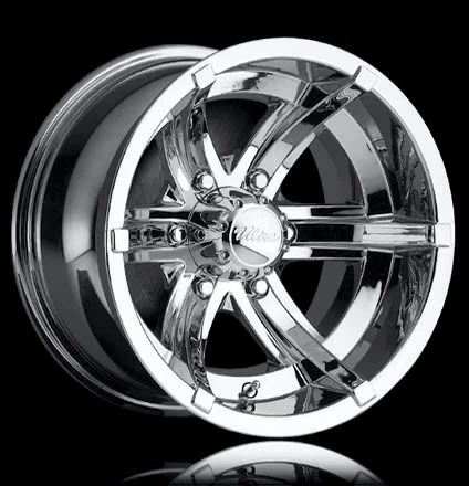

    Although it took forever, this rim came up at about 880 out of 1102 rims at some website that I can't remember the name of now. I know it's a truck rim, but it has the correct bolt pattern and backspacing! Yeah, Yeah, I know the pic has 6 lugs on it.
    Ultra Wheel - T6 Type 260
    [IMG]
    What do y'all think!

    What do y'all think of this wheel? Would you do it?

    Umm, I wouldn't IMO they're way too flashy and modernized. But I think thats just me. Try getting a wheel chop from the virtual body shop.
    Do they come in the 5 spokes? if so maybe. But I have my eyes set on 99-04 bullits, they look like the torq thrusts but bigger and IMO a tad nicer especially with the mustang emblem inside and they're relatively cheap compared to the other rims out there.

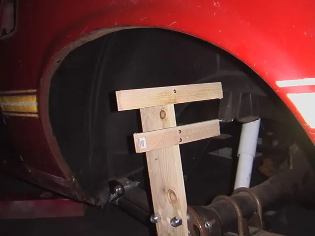

    extreme offset?
    The guy at PerformancePlusTire said that the 17x10s I plan for the rear has a real extreme offset and he would not recommend them for my car. I measured my car and this seems like it would be perfect. Which one of us is correct?
    Diameter: 17"
    Width: 10"
    Backspacing: 4.5"
    Offset: -25mm
    Boltcircle: 5x4.5

    Hmm, When I went to a rim shop they told me the same thing, a 10" in the back may cause problems and they don't recommend it

    I made this little wooden thingy that tests the different rim widths and tire sizes. There didn't seem to be a problem at 17x10. Can anyone shed some light as to what this guy was talking about?

    Actually, I like those rims - but not for the Cougar (or your Stang); because they just look like truck rims to me. I've seen them on an '03 Lightning in town; and I'm thinking they'd look great with some Wrangler AT/S tires on my F150 4x4. :nice:

    I agree that the last set of rims would look better on a truck.

    try that again with the jackstand under the axle. you might find some interference problems at the front inside of the wheelwell and also with the bumpstop.
