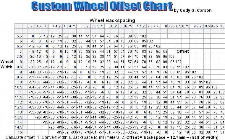

    I made this wheel offset chart to cover high positive offsets/ negative offsets and thin to wide wheels. This should cover the backspacing needs on most custom Mustang applications as well as Corvette and Eldorado/Toronado and drag cars. Use it to find your offset from backspace or backspace from width. It prints out on 8.5” X 11” paper and can be hung in your shop. I like to have a copy when I look through Jegs and Summit.
    Copyright 2009
    [IMG]
    Hope it helps you find your wheels,
    Cody G. Carson
