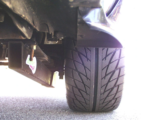

    here are a few photos of the rear tires. they are from last fall.

    It would be nice if you had some pics of the back end of that. Maybe some wheel well snap shots. I'd like to see how those fit.
