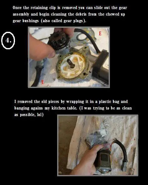

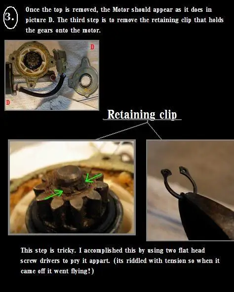

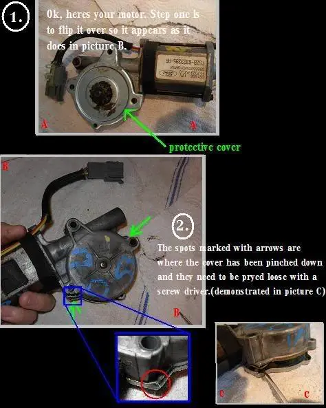

  8. Thanks RC, before I had time to see your post I just took the liberty figuring it out without any pictures. I threw a write-up together with much clearer pictures than the one I found earlier. Check it out:

  13. Big thanks to Stang netters for the tutorial on the window motor bushings. I was intimidated at first but after reading everyones success I went for it. My problem was my motor "failed" with the window in the down position. I wasn't sure I could remove the motor with the window down. I tried a tip I heard about which is to BANG hard on the area of the motor (after door panel removal) a few times and sure enough it worked to go up. I then pulled the motor thru the speaker hole. My bushings were not all chewed up but were oblong shaped and starting to split I think thats why my motor was binding up. Quick trip to auto zone and "help" section for the replacement bushings and window working fine after motor reinstall. Don't be afraid to tackle this. It cost me under 5 bucks, a little time and some greasy forearms! Imagine the money to have the dealer do it. Props to everyone who have put up tips for this!
