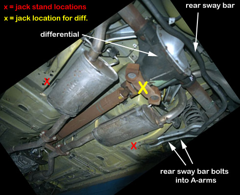

1. Jack up the rear of the car, and place 2 jacks stands on the frame in front of the control arms. (see picture). Jack it up as high as it can go�.again, you will thank yourself for doing it.
2. If you have 4 jack stands, jack up the differential about 5 inches and place the other jack stands under the axle housings. This will keep the differential from rotating up and down. If not, jack up the differential under the solid metal plate just in front of the pumpkin�.and jack it up about 5 inches.
3. Remove the 4 bolts (1/2") that support the rear sway bar, and set it aside. There are 4 speed clips that the bolts anchor to on the bar, try not to lose them. You won�t, but I�m just warning you.
