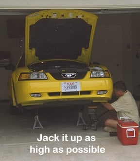

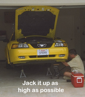

1. Again, jack up the car as high as it will go, and place the jack stands under the frame (subframes), and remove wheel.

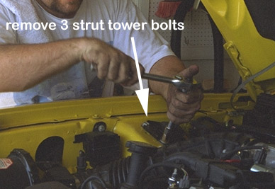

7. Strut. Remove the 3 bolts on the strut tower to remove strut. (see picture) (15mm) Once you have removed the bolts, GENTLY lower the jack, guiding the strut down, making sure it doesn�t hit the inside of the wheel well. Now, there is a plastic/rubber lining in the wheel well. The strut may get caught up on it�.just maneuver it around until it pops loose. I ended up jiggling it and pushing up on the liner to get it done. Keep lowering the jack until it won�t go down anymore, taking care to have your buddy hold the strut as it�s coming down. (you will hear a POP, that�s the sway bar coming off of the sway bar end�don�t freak. Now, the spring won�t pop out YET. Once the A-arm is all the way down, use a prybar to pop the spring out of the arm. Be careful, use a series of quick tugs and it should come out no problem.
It's possible for the strut to get hung up on the threads at the top. The first strut I did got bound somehow at the top. I giggled the strut, and it popped out and drop pretty violently. If it looks like the strut is not lowering as you lower the jack, giggle the strut before the jack is all the way down.
