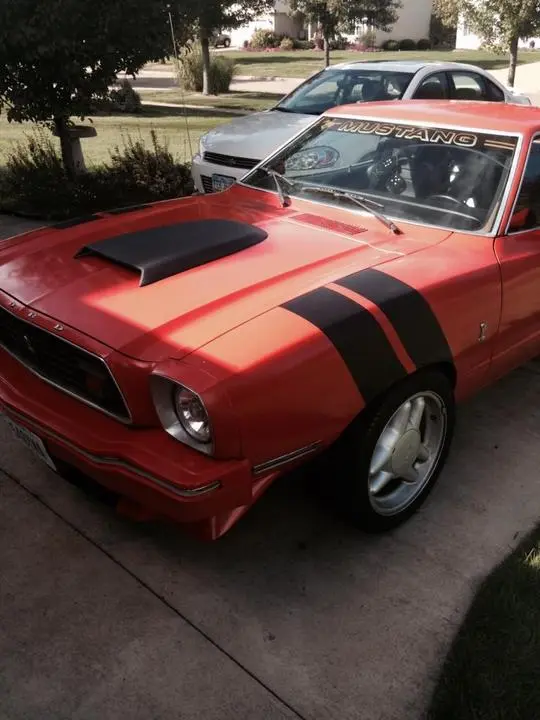

We made a few changes from an appearance standpoint, though the exterior remains the same. The $25 tractor paint-job is holding up extremely well and is very durable. It needs some fresh wax, I've been working on the turbo for a few months now so it's a bit neglected.

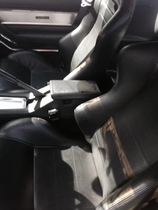

The interior got some eBay faux-leather racing seats with some custom-made mounting brackets that move the seats back as far as they can go for my 6'5" frame. They recline so I'm no longer bumping my head into the headliner. I picked up some really nice replacement seat-belts for the front from eBay, they're custom-made for the II by a U.S.-based company. They were pretty cheap too, about $45 a side if I recall, and bolted right in. No more crusty seat-belts that don't retract properly with sticky, rusty latches. On the rear seat I removed the ill-fitting cover and dyed it with the gloss Rustoleum vinyl dye. It came out really nice after some buffing with the wool pad.

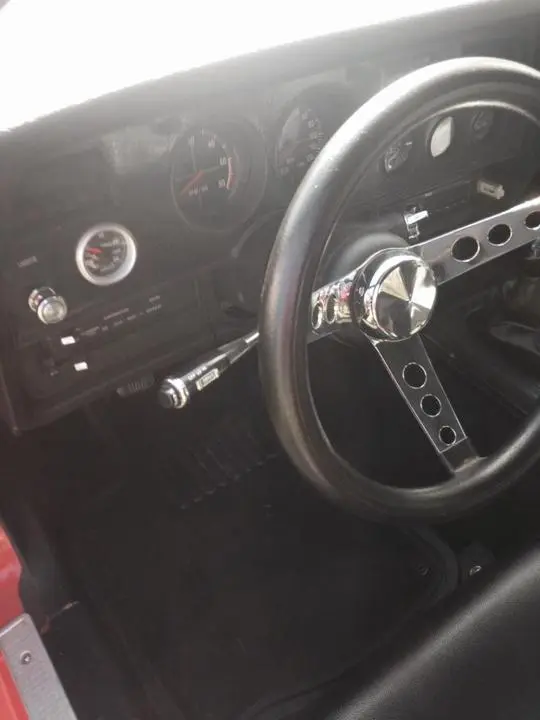

Finally in the front I decided I didn't like the grey vinyl dash inlays, so I went with black carbon-fiber instead, and added a boost gauge.

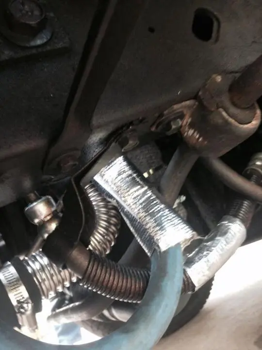

The hot-side piping came together pretty quickly. Lots of marking, cutting, and mig-welding sections of J-bends. The O2 sensor bung lets me plan to use a wideband to get everything properly dialed in. The one major hiccup I'd run into was that the passenger exhaust manifold, when swapped to the driver's side, wanted to exit right on top of the motor mount. eBay to the rescue, a passenger manifold from an '80's Ranger was a perfect work-around. I moved around a bunch of hoses, fuel lines, etc., to make sure nothing melted. Everything that was too close got some fire-proof sleeve. The exhaust was all painted with high-temp header-paint and wrapped where it got close to anything melt-able. The downpipe ran a little too close for comfort to the battery (as well as my removing the cooling duct), so that got a nice fire-proof battery blanket. So far it's stayed nice & cool (if that changes I'll relocate to the trunk).
The crossover runs behind the sway-bar in front of the oil-pan. It was a tight squeeze but nothing rubs at full range of suspension motion.

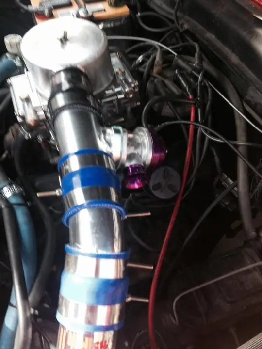

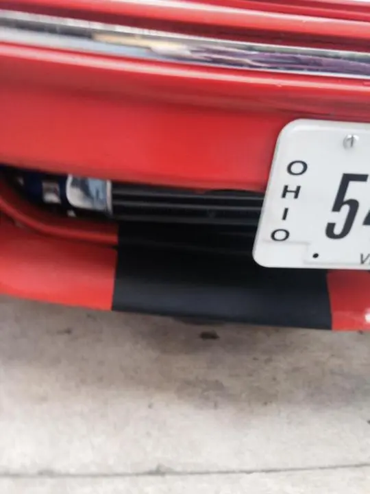

The cold-side came together in a few hours, I only need to cut a few of the pre-bent pipes. I mounted the intercooler in front of the A/C condenser, and snaked the pipes through the inner fender on both sides (I moved the ignition module over a little to where the voltage regulator used to sit for some room to bring the pipe through).

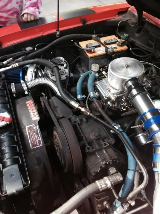

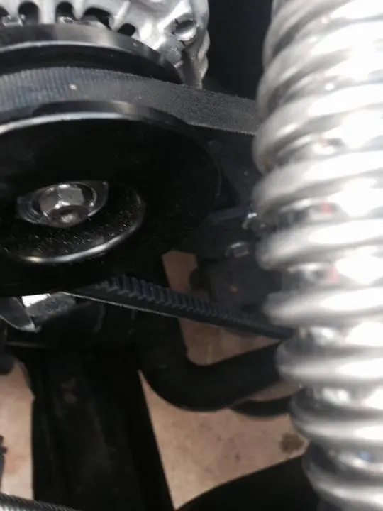

The last remaining piece to figure out was the alternator. I decided to go with a one-wire Denso-style racing mini-alternator. It puts out 70A and is tiny. After fabricating a sturdy bracket from 1/4" steel, all was well with the charging system. The only thing I've noticed is that the racing alternator doesn't put out much juice at idle -- it starts charging around 1100 rpm. No big deal for my uses, and the old alternator wasn't a whole lot better truth be told.
(if you look down under the alternator you'll see the crossover with y-pipe)

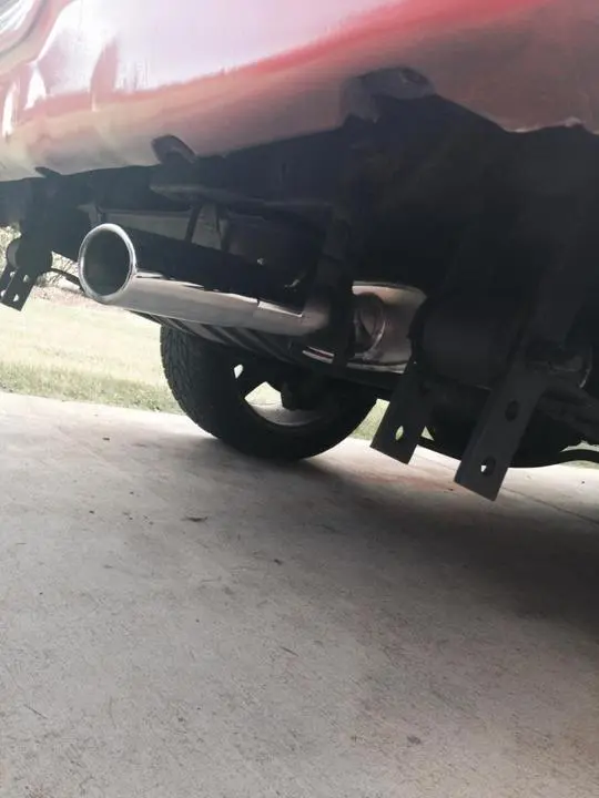

Since I had a few U-bends left over, I decided to fabricate a nice tail-pipe to run the exhaust out the rear where Ford had intended, instead of my old side-exit. I have to say having less fumes in the cabin was well worth the effort.
