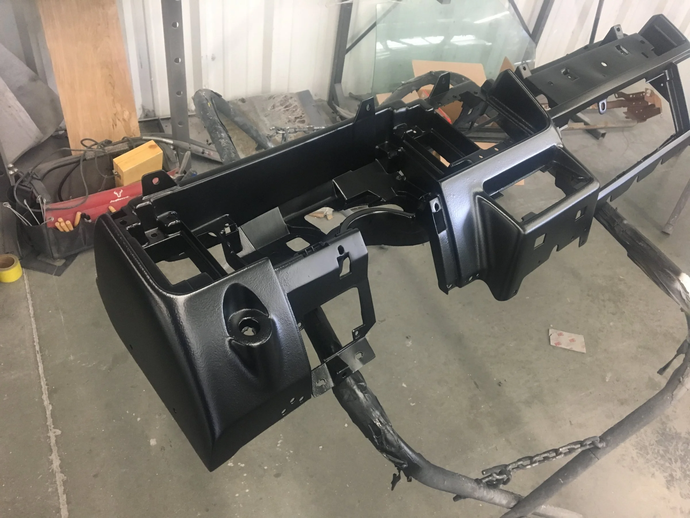

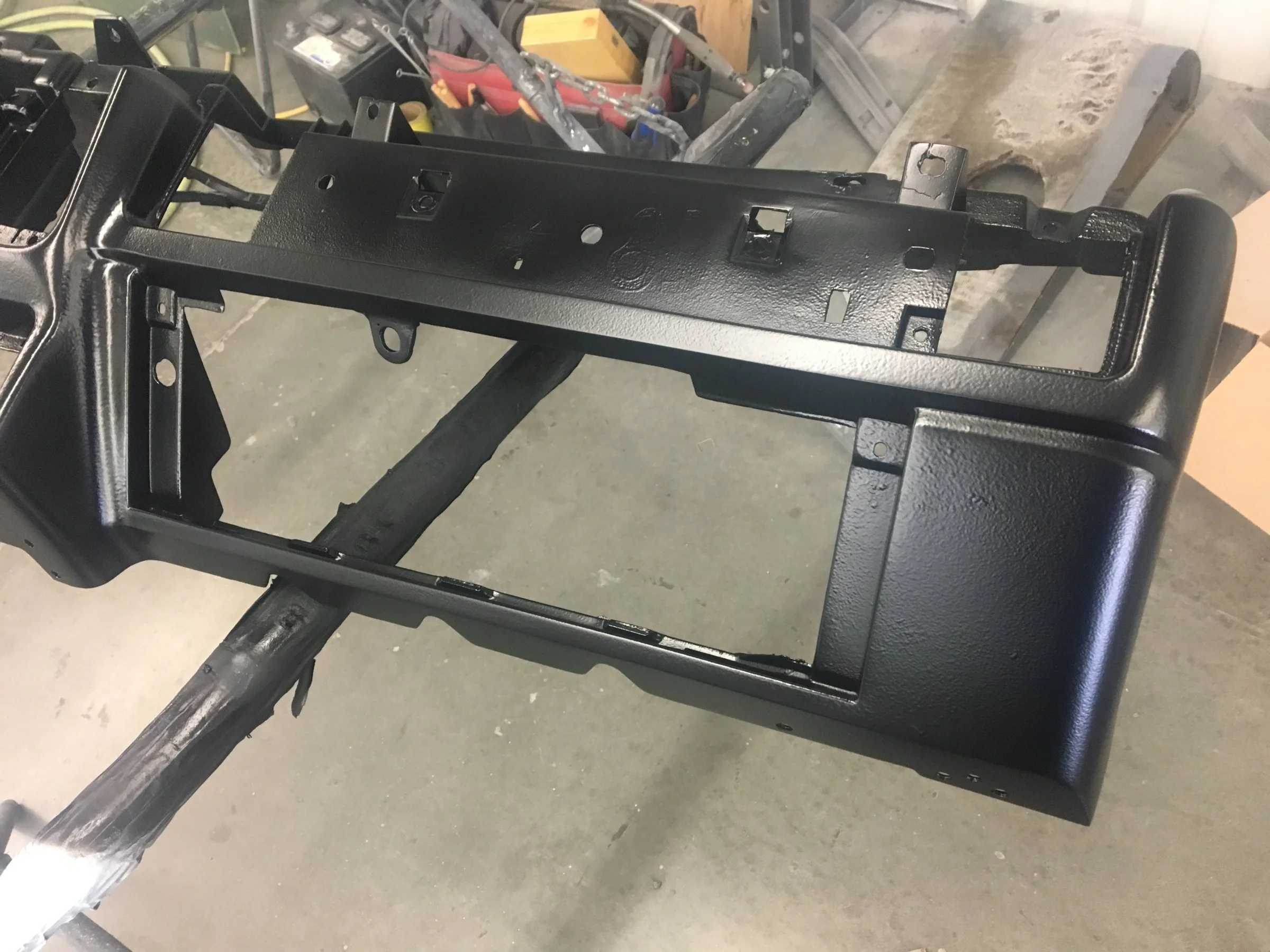

I got the IP painted today.
I'm caught in a bit of indecision now. I want to sand off the rust on the frame for it and paint the frame, yet at the same time I don't want to take a chance with messing with the grounding there. I might just give the metal a light scrubbing to remove the surface rust on it and just put it all back on the panel.
Anyhow, pictures. It was a long haul on this one panel. Not as long as the hood, mind you, but still......Jeez i'm glad to be done with it!

You could paint the frame, and during reassembly you can clean off the paint where you need it to ground. Make the connection, and cover it with a primer used on pinch welds for glass. Sika primer is a very good primer, if you know someone who works for Safelite, see if you can get a bottle from them. I installed windshields and glass for Safelite, and used that primer quite a bit to cover scratches and after doing minor rust repair. It resists corrosion like nothing I've seen before, and doesn't effect the adhesion of glass to the body like other primers do. Flash time is 10 minutes if I remember correctly.
My problem is knowing exactly how the grounds are made. I know where they connect to the frame, and I got a good idea how the ground to the body. I'm just a little tired of screwing with the IP at the moment.
I think I need to take a small break from it and work on the tops and the airbox. Sometimes it's not bad to walk away for a short period. The IP was very time consuming.

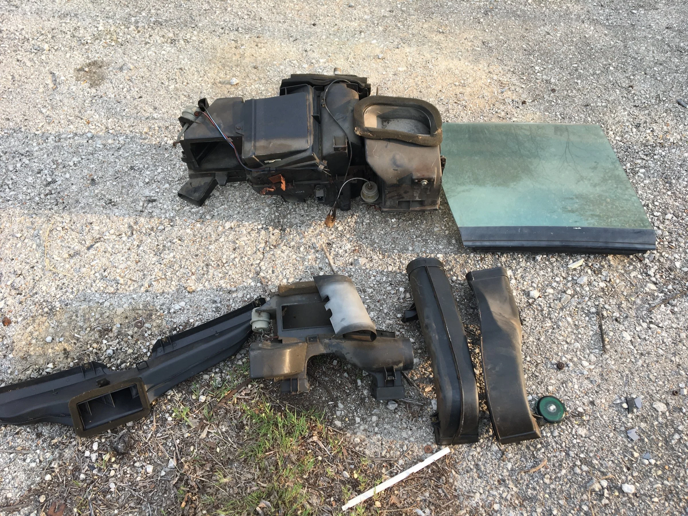

I did make it to the yard today. I swapped out the driver's t-top for a nicer one. I also got the air/heater box. You can't imagine how easy it is to pull that out without an instrument panel in the way!:doh: I also gathered up the ducting.
I'll focus on the tops next, one of those easy peasy things. I'll disassemble this one, clean the glass and sand down the trim and paint both of them grey. Then I'll reassemble them with their new seals.
Then i'll disassemble the heater box. Tomorrow i'll pluck out the old heater core just to see what surprises await me on the inside. In a couple days I'll tear it down completely and literally clean the crap out of it. It will receive several disinfecting baths. Last one with some sort of febreeze type of cleaner....hum......spring breeze or linen fresh?
You'll also see the top trim for the steering colum, I'm not sure I got the right type. I'll find out tomorrow.
