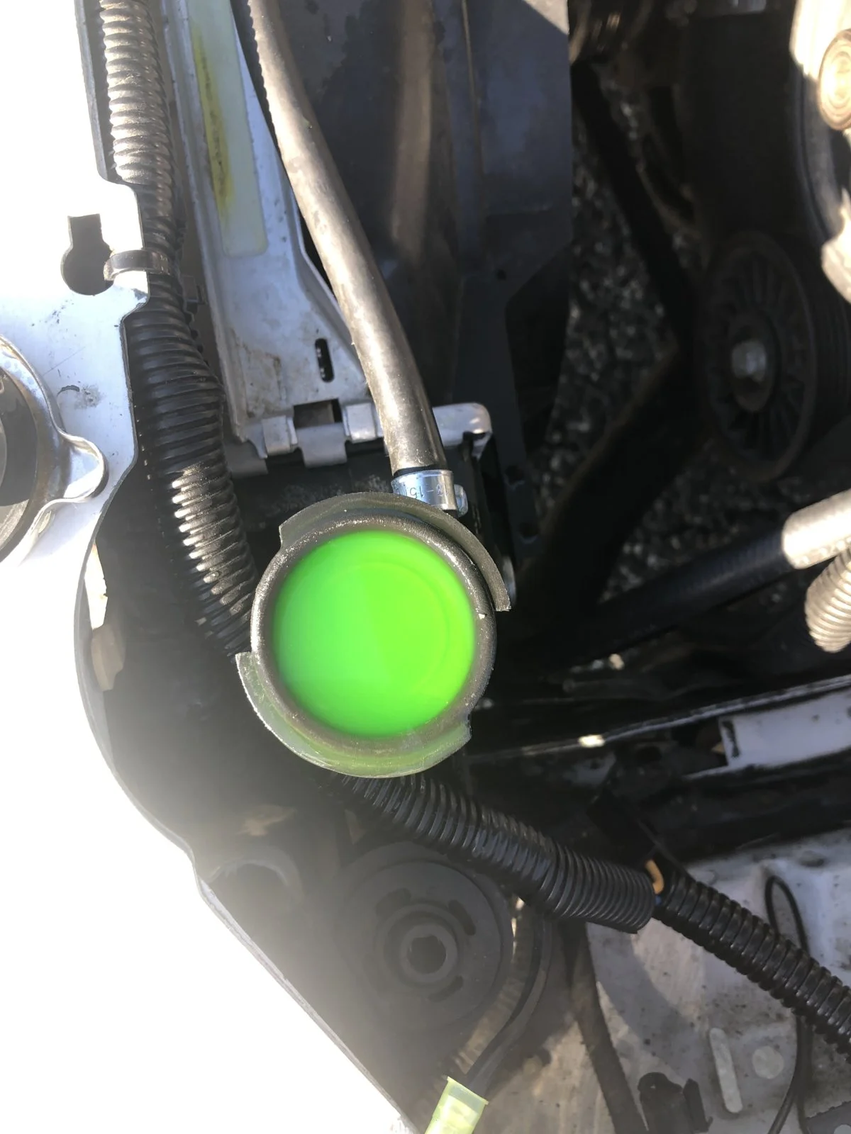

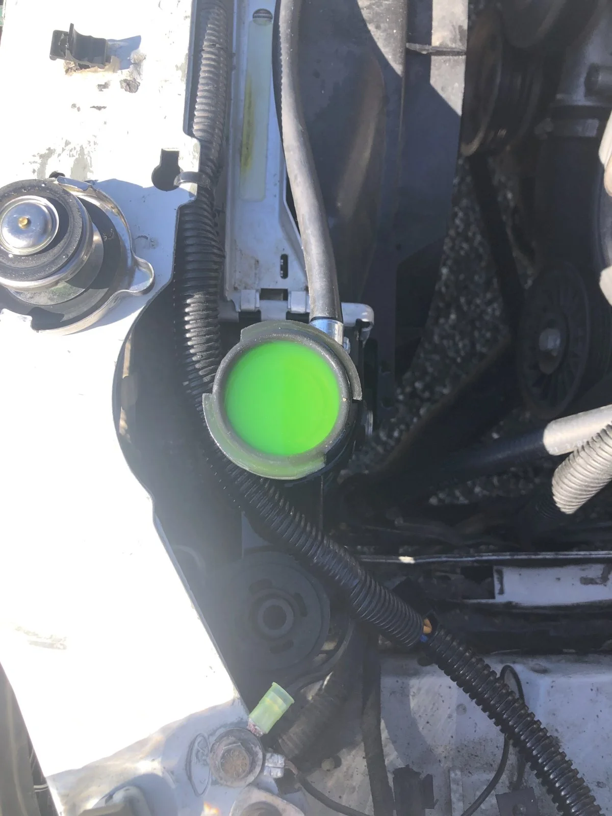

I’ll check the coolant right now, do you know where I can find a cheap block?
Pic
