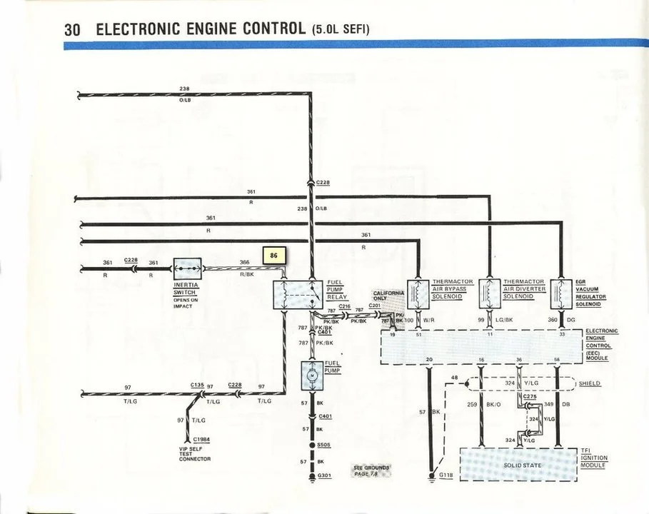

That's not a very useful diagram. You need this one:
Diagram of the fuel pump wiring for 87-90 cars.
attachment.php
Notice that wire from the fuel pump relay goes to pin 19 on the computer: that's what gets missed in some Mass Air Conversions and sets code 95.
Could you explain why? It looks the same to me. Diagram is from 1988 Ford EVTM. I also have the original 1988 Ford Wiring Diagrams, many pages but too large to scan.
The entire 1988 Ford EVTM is on my website.
For me, the visual quality of the Ford diagram makes it hard to read. I have a 92-93 set of the Ford EVTM diagrams and they aren't any better. It may be just one of those personal preference things.
Thank you; now understood. Probably instead of "That's not a very useful diagram". it would have clearer to me if said: "That's not a very readable diagram."

I have found a discrepancy between your drawings and the Ford EVTM:
TAB to EEC (White/Red) is pin-51 (not pin-38) on EEC
TAD to EEC (Lt. Green/Black) is pin-11 (not pin-32) on EEC
However, the Ford Wiring Diagrams agree with your pinout.
I found this out when following your recommendations to monitor the toggling of the voltage when in test mode (KOEO). 12V is present but there is no toggling to ground on the TAB or TAD. This would explain why codes 81 & 82 continue to be given when the solenoid valves are tested good. This would also generate the codes 44 & 94 if both valves are not actuating. Ran out of time before attempting KOER, but it seems unnecessary until codes 81 & 82 go away.
It's either the wiring or the EEC. I still have the original SD EEC & can substitute it for the MAF computer. Supercharger belt is removed & air will draw through the entire system as if it weren't there.

A. Could all these symptoms be a bad O2 sensor, i.e. carboned up?
B. Could one of the cats be clogged, forcing much to the other cat?
It's not as bad as when the supercharger was running, but as soon as throttle is opened (maybe 20%) & vacuum goes to 10-15, it's a Wild Mustang again. How do I tame this beast?
There are no bad codes at all.
Cylinder Balance Test reports all OK.
Bad O2 sensor will set codes 41/91 or 42/92.
Try putting some window screen in front of the MAF to see if there are any turbulence problems in the air intake. The stock 55MM MAF had one.
