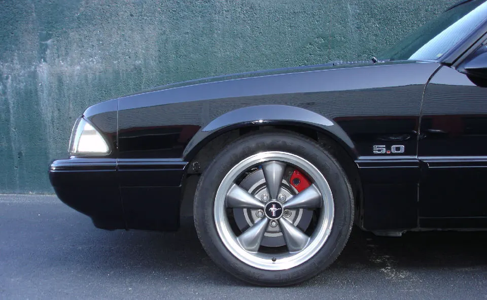

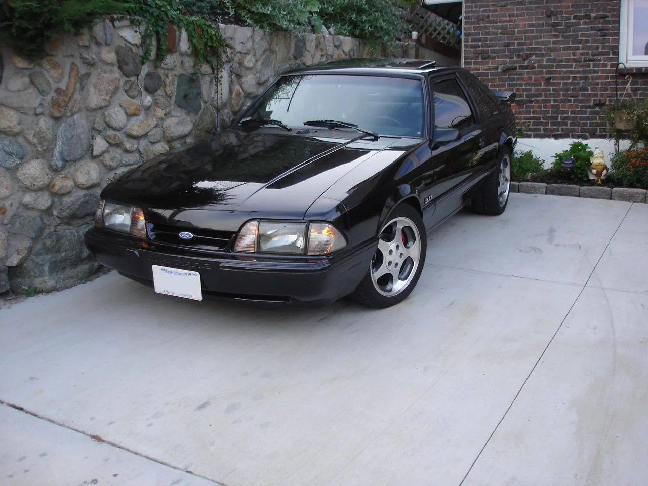

Anyway, here are some pics.
this is with FOX lenght axles and 17x8's. They aren't bullets wheels, but they have the same dimensions. This is with rear drums. Forgive the dirtyness...this is an OLD pic..prob 5-7 years old. It's one of the better to show just how tucked the wheels look. This is also with the SVO 5-lug rotors...even the fronts look tucked.

This is with SN95 cobra front and rear disks and SN95 width axles. I have the rear jacked high with my adjustable arms, but i've brought it down since the pics. Clears fine unrolled, but i recommend rolling the rear fenders..it's close. This is how the car looks today (fortunately). I have chrome 01 style cobra wheels going on soon.
