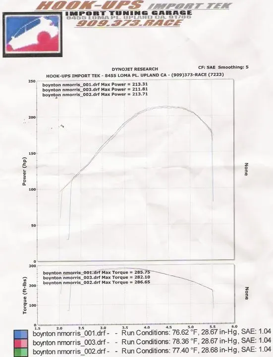

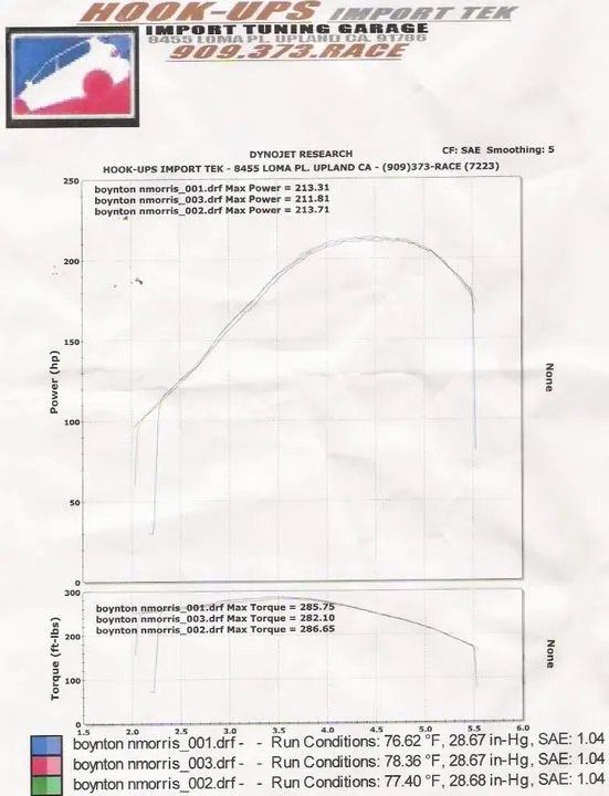

I just dynoed today with my new combo. I hit right at the HP I thought (257HP SAE) but my torque curve is extremely good. I averaged 284RWTQ across the whole 2,000-5,600 rpm power band. I care more about torque than HP for a street car and if you have experienced 275ft-lbs at 2,000 rpm you know what I mean. I was ALL smiles.
i've got a stock intake and im hitting 290rwtq somehow.....
Morris - the mistake nearly everyone makes is actually taking their dyno numbers seriously. The dyno is only useful for making back to back changes during the same strap-down under similar ambient conditions. There are simply too many variables between conditions, operation, programming, etc. for anyone to conclude that the numbers produced are actually accurate. So, they're good for measuring comparative changes during the same strap-down session; they're pretty good for noting where your peaks occur rpm-wise; but they're nearly useless for concluding anything absolute about the measurements. A few psi difference in rear tire pressure (which can occur from one run to the next due to heat buildup), and tightening a strap one click can alter readings as much as 10-15 HP. Drive your car to another dyno, even of the same type, and the numbers could be significantly different.
