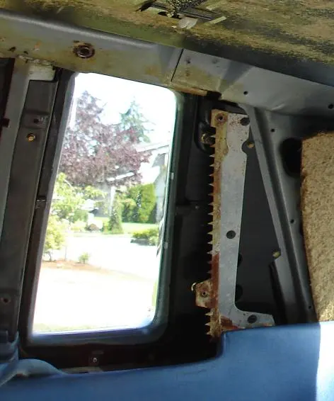

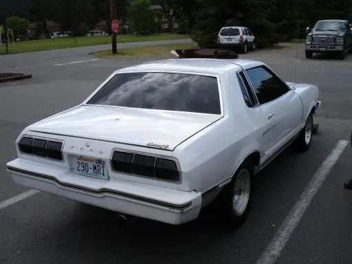

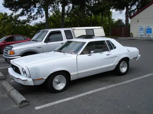

Here is one of the pictures I took of my Ghia. I'll see if I can find another picture, if you need to see more details.
The car is in the shop right now, but I can get more pictures once I get it back. The headliner is still out until I get a new vinyl top put on.

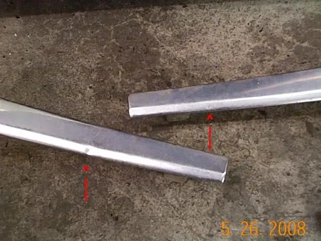

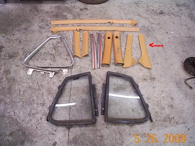

Ok James, here's what I have on hand at my place. I may have a set of different color over at my dads. Forgot to crawl up in his shop's attic and take look. Didn't know of color was a big issue or not. The 1/4 glass are clear, not tinted. The two 1/4 stainless pieces both have little tiny dings in them, easily worked out if you know how to massage stainless. They are really small. I'll also look over at dad's tomarrow for nicer 1/4 stainless pieces. Anyways here's the pics.
Now you see that red arrow in the top pic? I wasn't 100% sure if you needed these. I'm thinking that they are more for the rear window trim more than the 1/4 window. If you need them, fine, if not no biggie. The arrows in the second picture show the very small dings. Other than that they are pretty nice pieces. Flip me an E-mail and lemmie know what you think. :)
