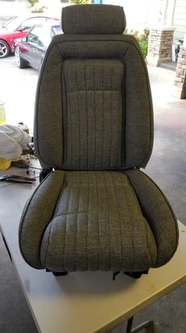

I recently changed over the interior of my 93 convertible from white leather to opal gray cloth. Painted the interior using the products attached (mostly the SEM). Bought Acme Headliner door panels and seat covers through Rock Auto. Very very close to opal grey.

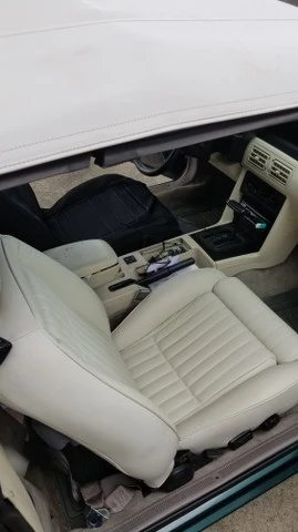

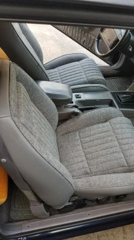

The opal gray vinyl spray works real well. I have used it. They also sell new leather upholstery in opal gray. I did my convertible seats (white leather), it was pretty easy and came out good. I also did my 93 coupe seats in opal cloth, also came out good.

The cloth looks really good. I may just stay with cloth instead of switching to leather.

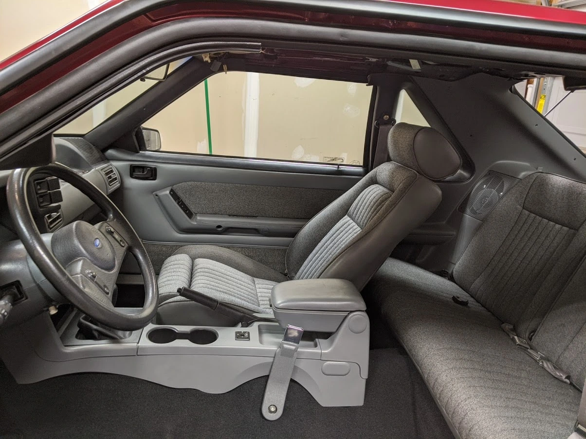

hate to dig up this old thread but my 93 coupe is in paint jail. While it's incarcerated, I am going to work the interior over, meaning it's time to re-dye the plastic parts to get rid of the fade. It is original Opal gray interior (93 only color). Also replacing the center console arm rest and the two door arm rests, and finally getting around to painting the cupholder console while it's out. I'm probably going to end up doing the entire interior as it really is in need of some TLC.

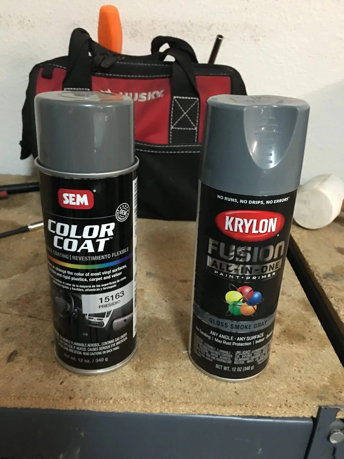

What SEM works best? I mean what is the code on the can? 15813 or?

From what I've seen so far, SEM Presidio 15163 is a close match and people have used that. I used the kit available at LMR.com MET-FV45K and works great. This guy on YouTube used the Presidio color for redoing his interior.
