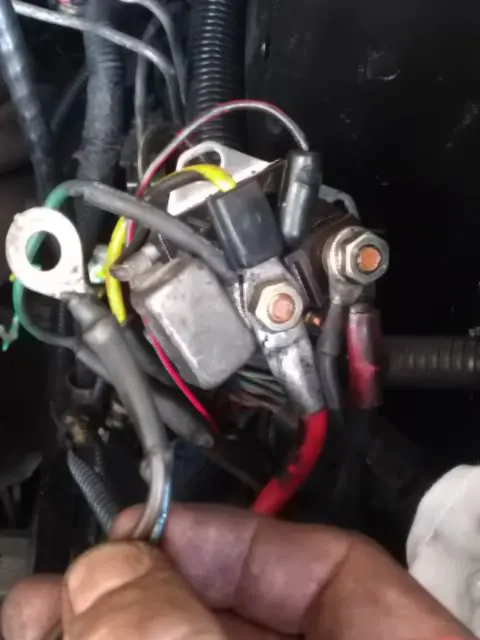

Unrelated. If your working on your car today, can you take a picture of this? I have the wiring wrong and need a guide. I'd really appreciate it.

As far as your picture and the picture your needing, what is that picture of? Your starter relay? Or is that the 75 amp relay? Just let me know what you need, and I'll take a picture of it. If you want PM me your # and I can send you a picture of it (whatever it is) now (I'm at work with the car)
