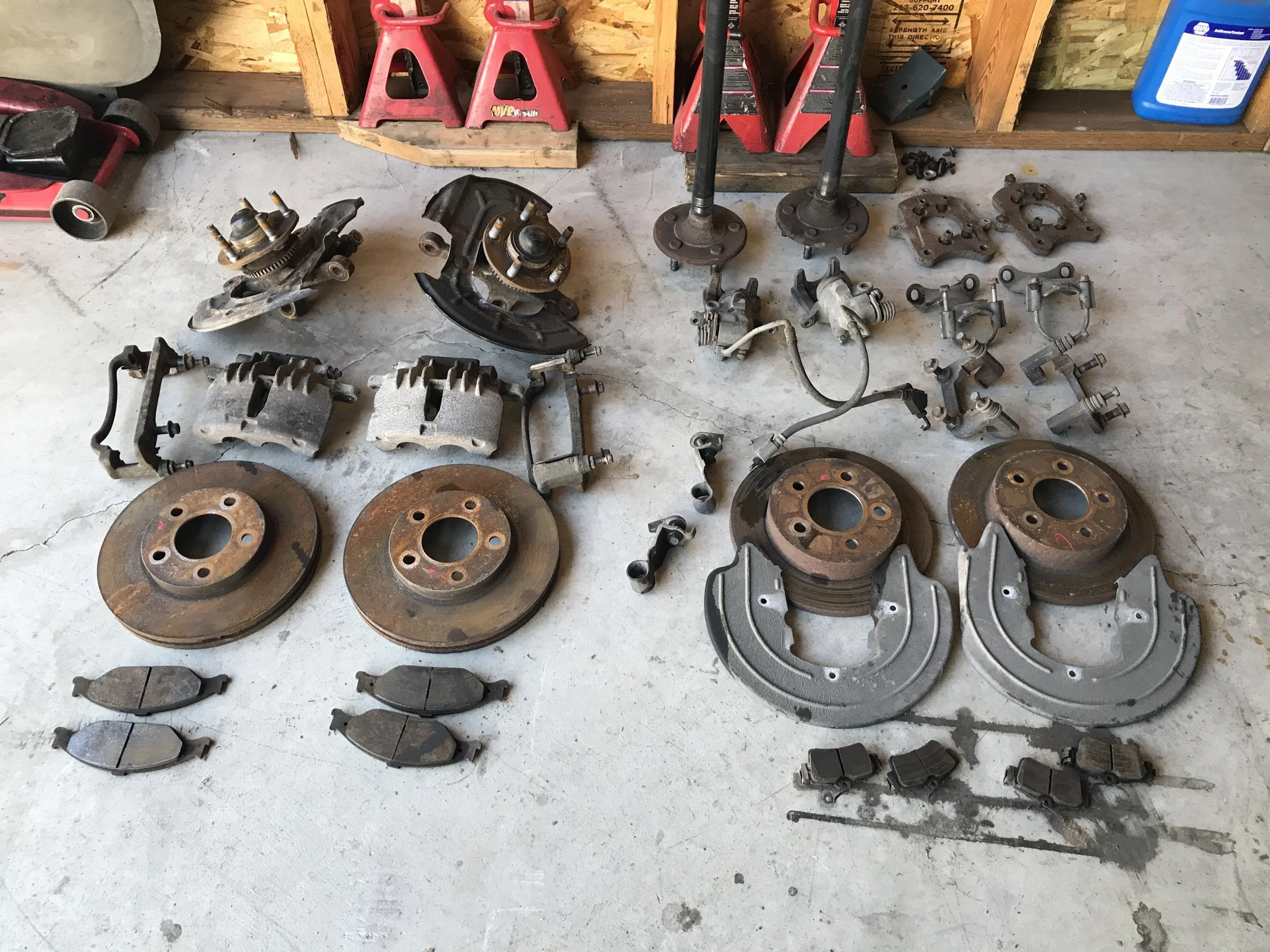

Get It Did!Junkyard run this weekend, beginning to gather 5 lug parts...
Now the rear I know I should be able to find some Ranger axles, not clear what rear brake parts I should snag, I think I will grab the rear brakes, calipers, disk, brackets from the same 96+ cars I am pulling the fronts off of.
Since the 85 has 7.5 stock in it I should just get the entire 8.8 out of the 96. I think the axle housings are the same width and in my instance the extra axle length will make the 8" wheels fill the wheel wells better. Right?
Cool I would image the brakes and brackets are the same also, please correct me if that is wrong.
1996 V6
Spindles
rear axles
rear brakes, brackets,
parking brake handle and cables
2002 v6
front brakes, disks,
am I missing anything ? these cars were pretty complete last time I was there, ( 2weeks ago )
