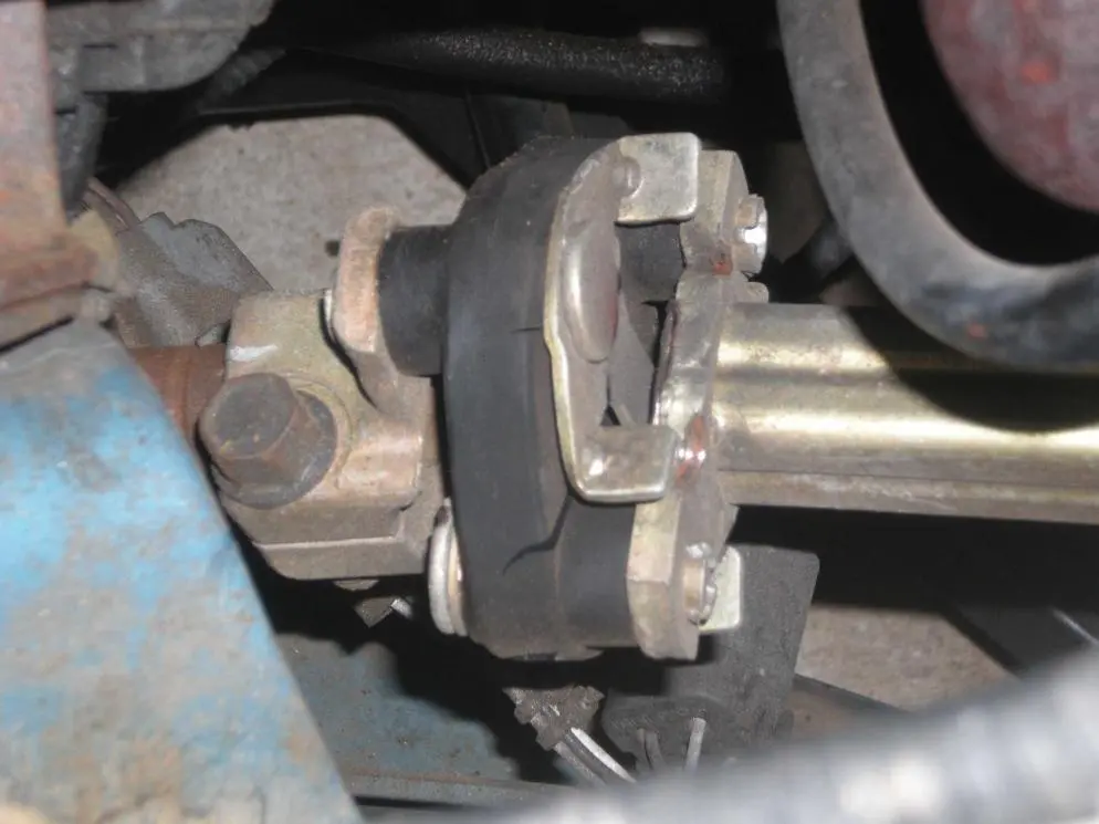

If you get the front end high ebough, you can come in behind the front tires abd see where you have a straight shot to the rag joint.

So the rag joint seperates? Does the lower half stay on the rack when you pull it out? You spin the pump by hand first with the car off? Then run your belt and turn the car on and go lock to lock?
Here's how I did mine, the rag joint has two bolts with nuts or you could take out the nut/bolt between the rag joint and the rack like I did.

The steering shaft has a connection at the rack and up near the firewall. You'll want to loosen the bolt atbthe rack and take it off her
That's how I had to install mine when I did my SN95 rack and MM adapter. I tried installing the adapter on the rack first and going in that way just having to connect at the firewall and it wouldn't work. There box around the steering shaft prevents you from doing this that way.

The flex coupling for the steering shaft needs to be disconnected before you can get the rack out. You should disassemble the coupling by removing the 2 bolts that hold it together. The lower part of the coupling will then come out with the rack, and can easily be removed.
