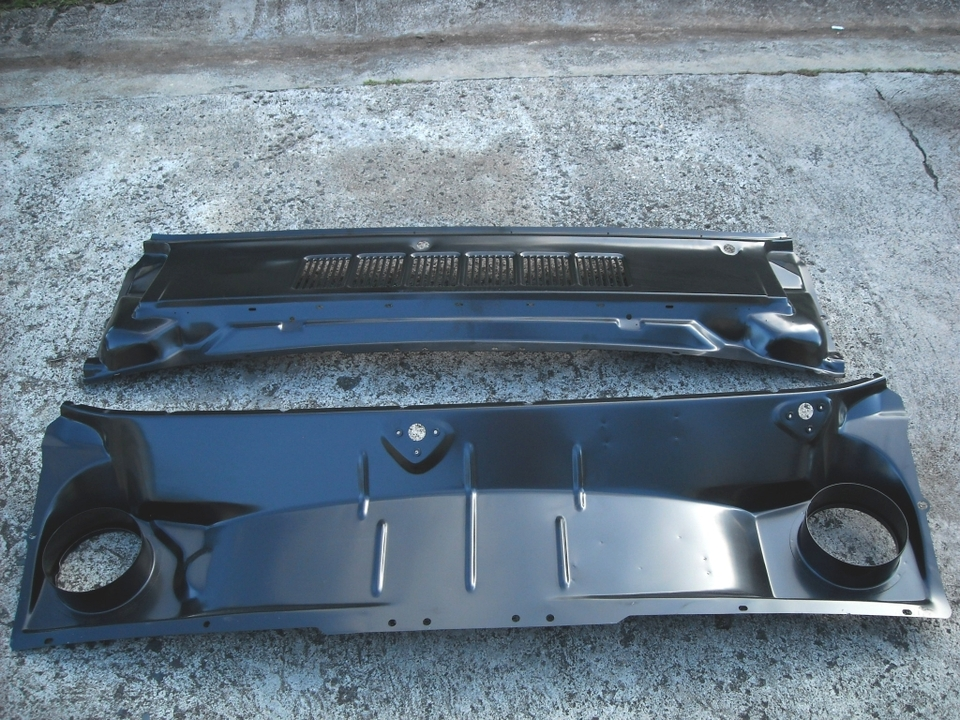

    Now, there is good news on the 64-66 reproduction cowl from Mustangs Unlimited. I just came back from my body shop guy with photos of a "Just Arrived" version that is 2 pcs. This one has a Scott Drake Part num on it and the packing box has Blue stamped letters at the bottom that says "Mustang Cowl Panel Grille Assembly 64-66" not the generic carton box of the other one (See photos below) It has the same crappy primer and weights 43.8 pounds. That’s 7 pounds less that the Old Taiwan version. Looks like an improvement over the other one. Tomorrow it will be test fitted to a 66 vert and I will report on the findings.

    It'll fit, but it's not right for a 66. Look at the wiper holes in the top.
