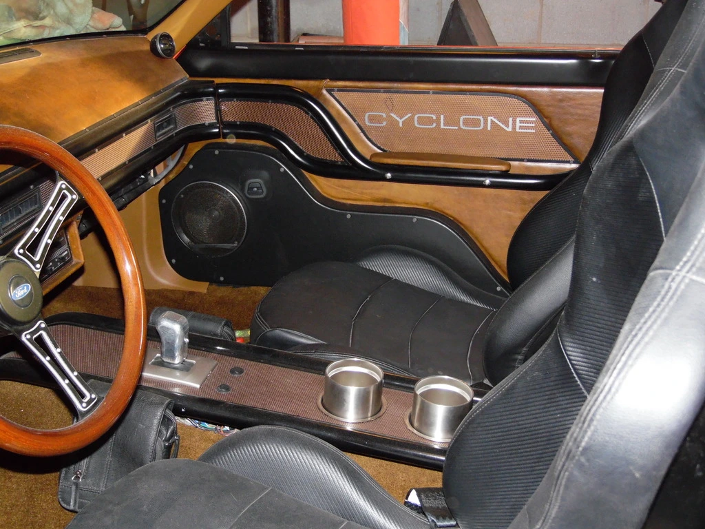

I'll just sit in the car. I don't even need it to run. I'll just sit there and make engine and transmission shifting noises. I may even move the steering wheel slightly for the full effect.
One thing I have noticed is that the "cabin" is very tight. Unless I just forgot how "compact" a fox actually is,..it seems really small to me in there. Even the rear seat space seems like it aint there (which I thought was more considering a FM has a 5" longer WB).
But I'm here to tell ya,....It's all good. It's a freakin cool space. And I don't mind braggin',..(out of character for me I know).......If you didn't know what car this thing was originally, and you just ended up inside it,...you'd have no reference for what it used to be other than the ford emblem on the steering wheel. The only things that would give the car away are the kicks, and the rear quarter panel trim pieces,...they are the only thing that hasn't been modified in the interior.

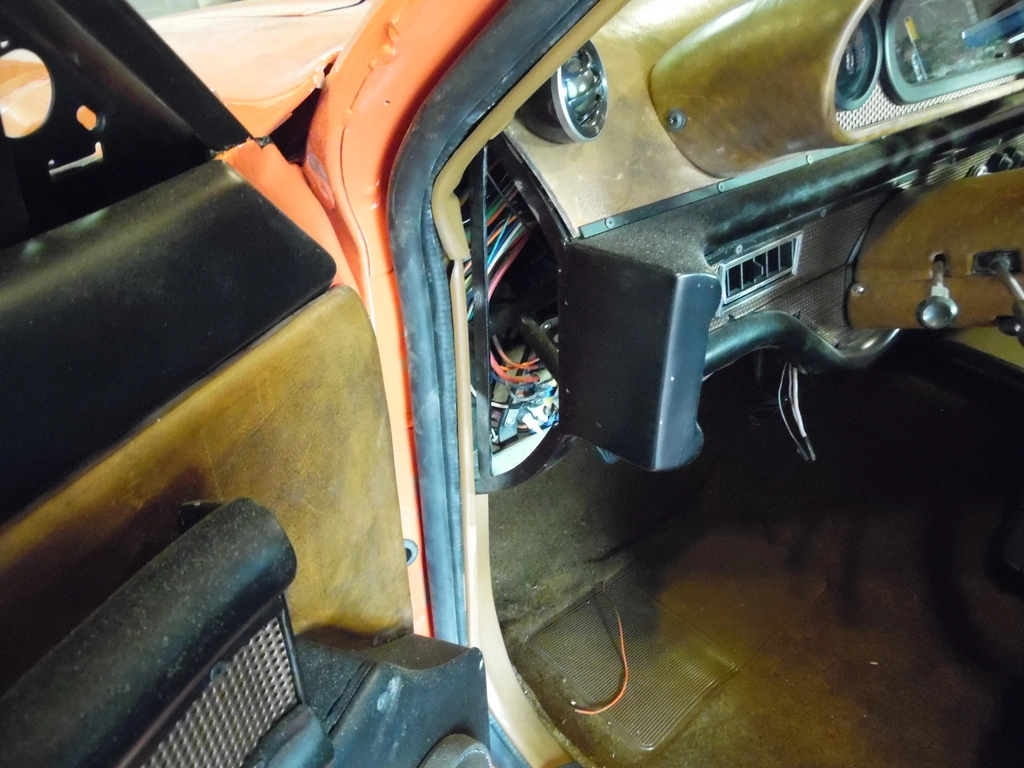

In the pics you'll notice (maybe) that the bottom covers are still YTB installed. #1. I gotta make sure that my PC will connect to my MS via the bluetooth adapter I installed (it already has,....I just wanna be sure) and #2, In case I have forgotten some wire or circuit. Once the bottom pieces are screwed in place, and the trim piece is screwed on top,..it'll be a pain in the ass to have to take all that junk apart if I missed something.

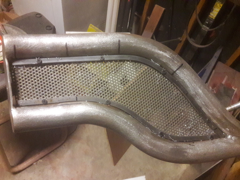

Still left to do are the end caps...
Right now,..the plan is to just build a plate that will be padded and upholstered the same as the dash,..the only hitch I see is how to blend/cap the sharp edges of the cut off top, and bottom pieces.
