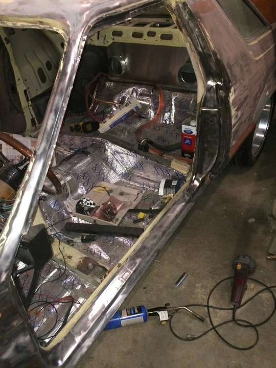

However, no sooner did I tell her that, and grinder #1 takes a dump. Typical HF failure,...the brushes wear out. Although they include another set most of the time, the stupid plastic caps that hold the brushes in are fractured, so when I go to replace them, the cap comes out in pieces.
I hail mary the thing into the trash can.
Now I'm down to 1.
Fast forward to today, and grinder #2 slows down in my hand. I smack it, and it speeds back up. The rest of the day, It struggles to do what I needed to do, eventually giving up the ghost as well. I throw it down to the ground, as hard as I please.
They lived a decent life. They managed to get through more than 3/4 of the way through what will amount to be a 3 year build.
