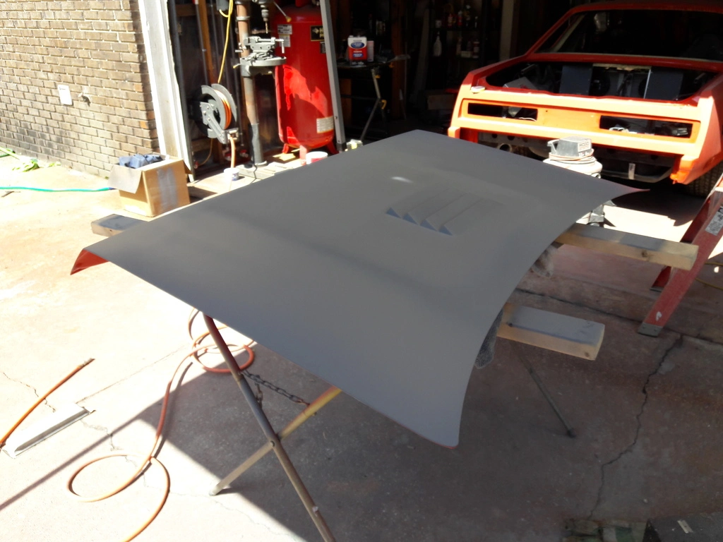

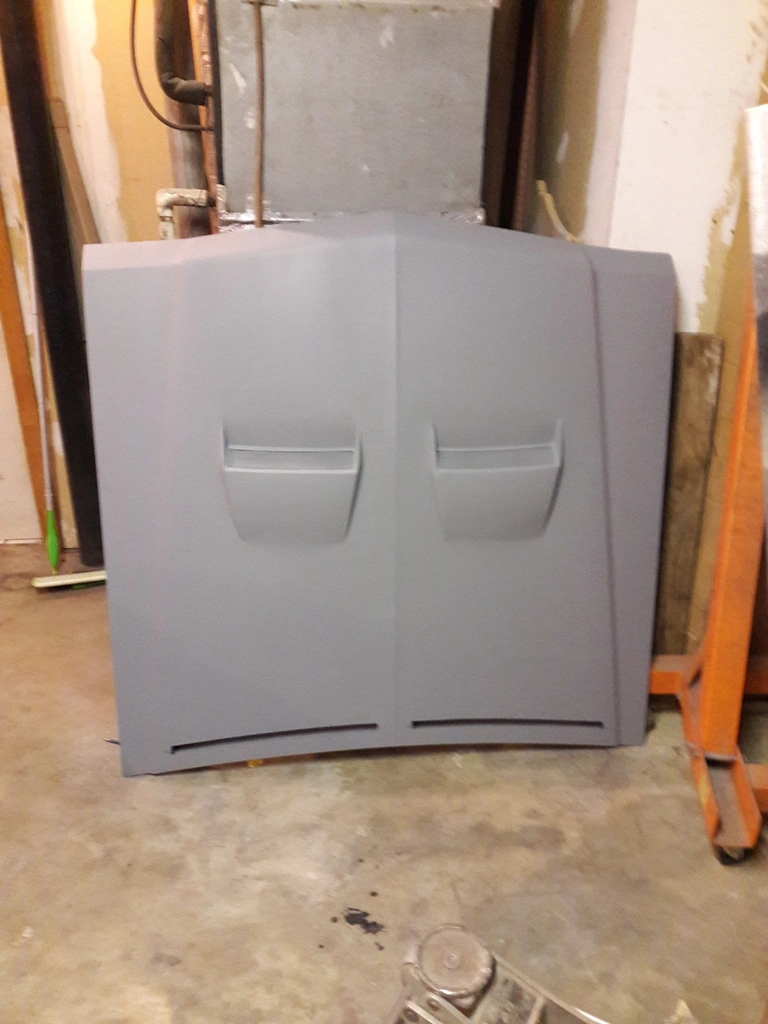

The hood from hell.

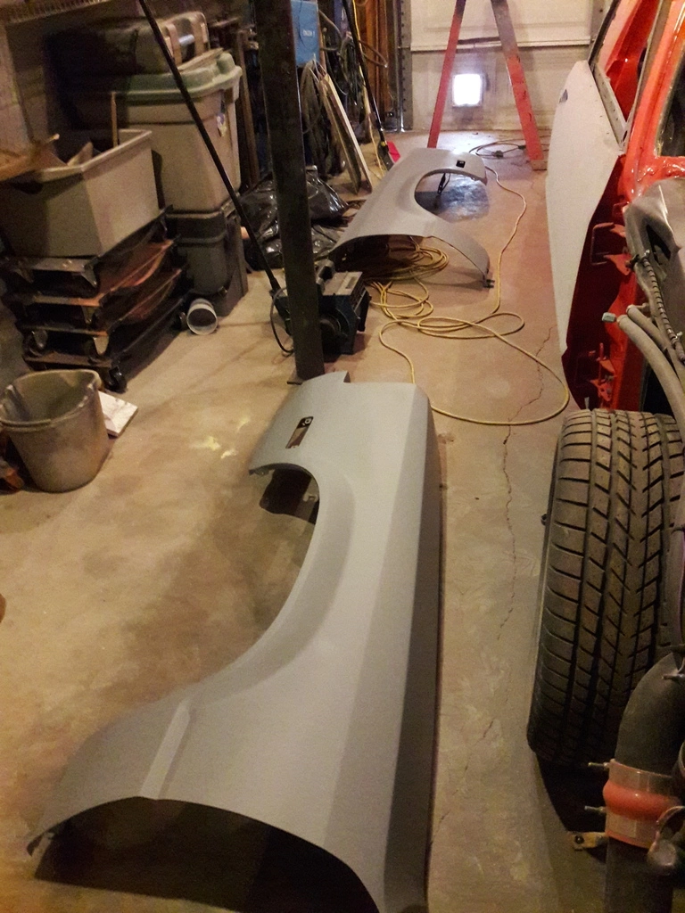

Fenders waiting on time to dry.

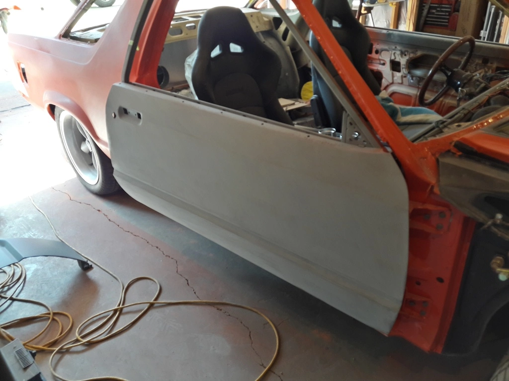

Passenger side door. Already blocked,....done.
Driver's door. Waiting to dry and blocking.

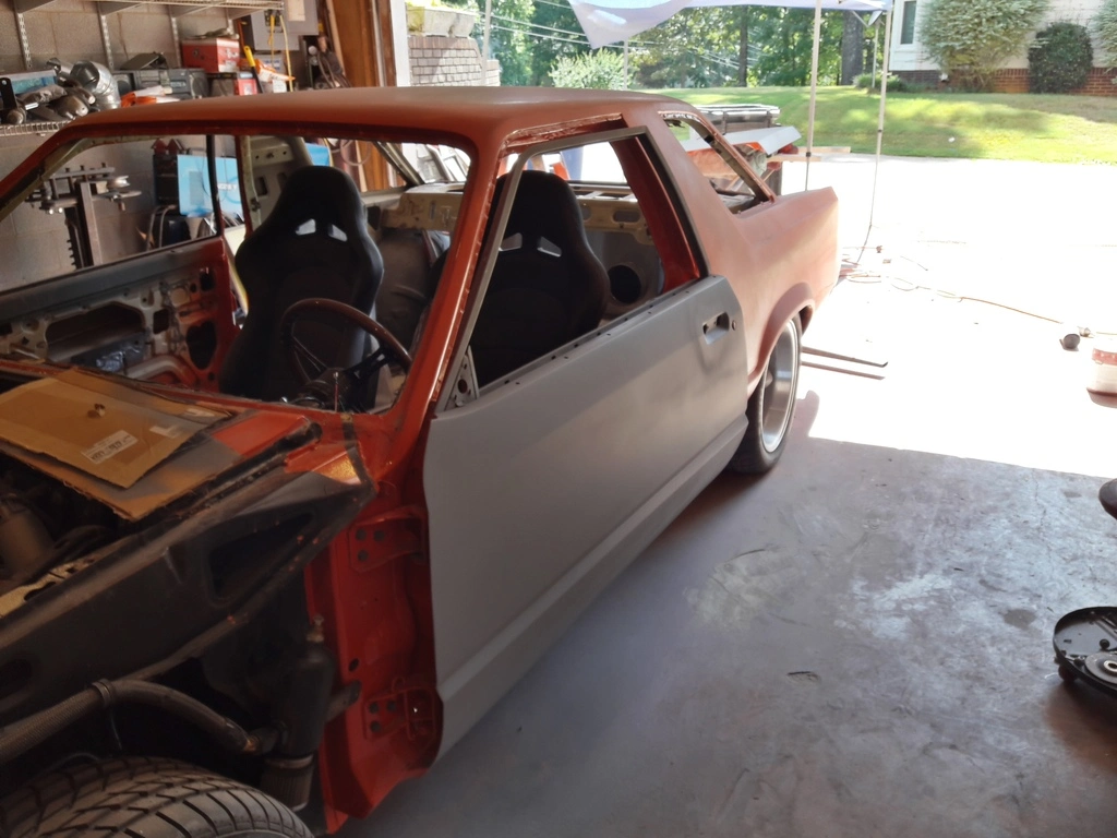

The pics typically help me to see what I can't when I stand there looking at it but they don't lie. The center rib has lost it's definition between the scoops, and the left scoop needs blocking more to level out the bulge at the rear-most part of the thing. These pics are after three coats of fresh primer, so at this time it's still too fresh to hit with a sanding block and some #320 paper. What I'm hoping for here is that the blocking regimen will add back some of the lost detail that happened as a result of having to fill the damn hood to get rid of the wavies. I said it last time,...the irony of the whole damn thing is that this hood looks like the original that was at this stage two months ago.
Is it 80%? Hardly. Can I get it there? More than likely......(maybe a 60%) . I'm just done. As in,.......wiped. It seems everything I do to try and make it better adds tons more work, as I make a bigger mess everytime I touch the damn thing.
Save for the blocking and priming,.....that's all I'm gonna do to this bastard.
Hoods are the lesser evil. We'll paint this pig, and it'll be ok for now. Then I'll start to dislike it,....Then I'll just hate it. Then I'll start all over again. Only I've finally learned my lesson.

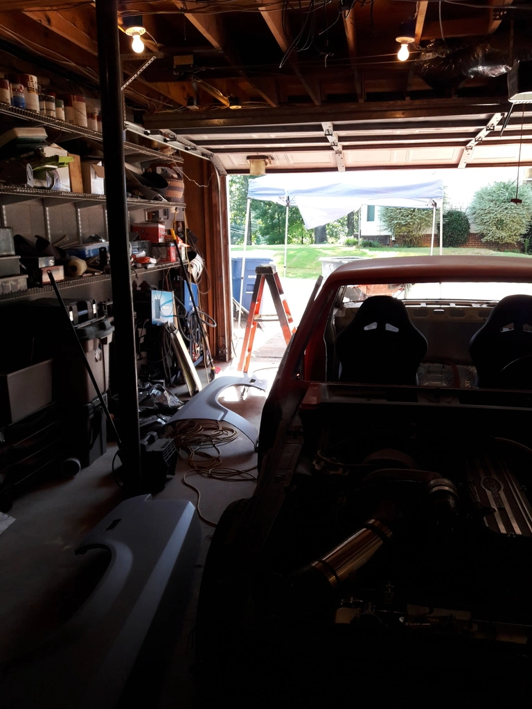

We're painting the car right where it sits. Part of what I gotta do to facilitate that is mega clean the garage. I intend to make the garage "itself" the paint booth. Air is gonna be forced in through three furnace filters right here,.....
When we paint, I'm gonna have a "door" with two box fans that'll blow in. I'll just open the door you see, and close my fan/filter door from inside the garage. Conditioned air from the house will be the source for Mike's paint booth.
At the back of the garage will be a wall covered in clear plastic that spans the entire two car garage door. When paint time comes, the O/H garage door comes up, and exposes that wall. At the bottom of that wall will be three additional fans pulling air through three filters.
It'll be "back there".
I'll make a "Man door" so we can get outside into the fresh air through that partition. It's really about 10 studs, cut and screwed together, then screwed into the frame that surrounds the garage door from the outside. Should be easy-peasy. It'll be this Sundays' work goal.
