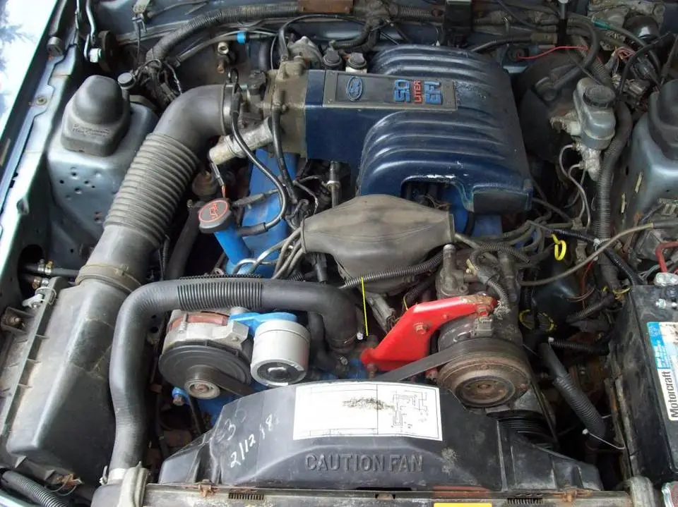

On the attached picture, this is the motor shortly after it was put in the car and you can see where the distributor and TFI are located. This was before the intake gaskets were done and there was no noise. The yellow line represents roughly where the TFI sits now, it’s as close to the thermostat housing as possible, and it’s touching it. Now if I move the distributor counter clockwise to move towards where it used to be the engine runs real rough
