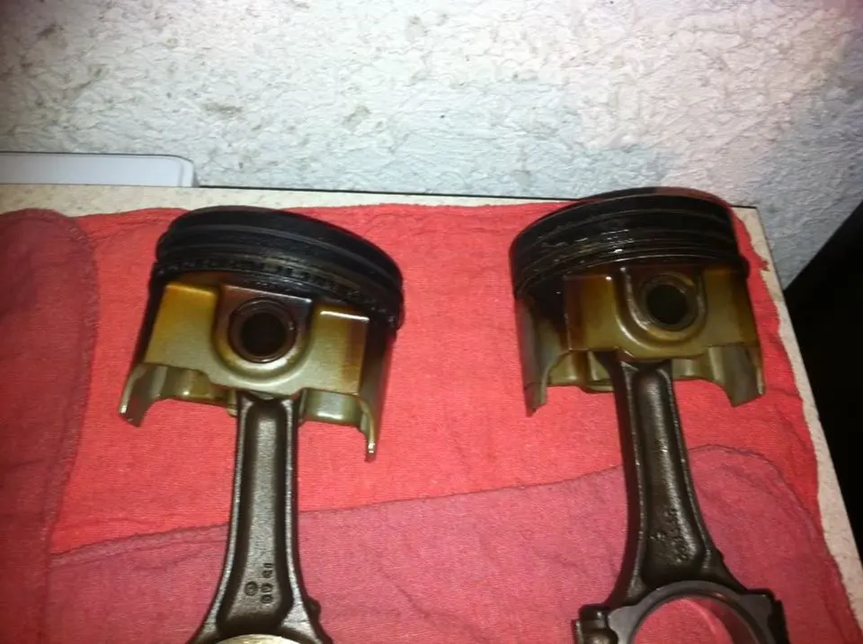

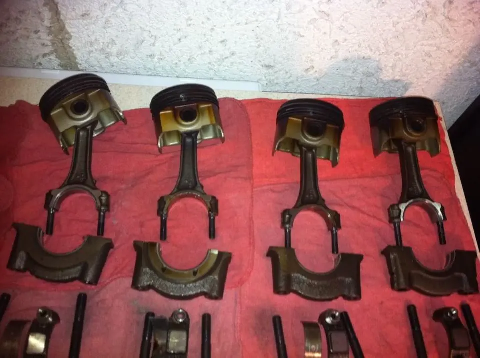

  10. Bansheeman6100
    Joined:
    Mar 15, 2011
    Messages:
    185
    Likes Received:
    Trophy Points:
    17
    ok, got the piston out. the only way it was going to happen was for me to cut the rings off. tried to compress them and tap it out, and it just wasn't going to happen. now i need to measure them and order replacements and a gasket kit. and this is going to sound a bit ignorant, but they look a bit burnt. is this normal?

    Joined:
    Sep 9, 2000
    Messages:
    4,569
    Likes Received:
    Trophy Points:
    69
    Location:
    Antelope Valley, SoCal
    If the cylinder ridges were tall enough to give you all that trouble getting the pistons out, then the block likely needs to be bored and that means new pistons. 87-89 octane?! That's not going to cut it if you want any kind of power out of the engine; even a stock one is going to pull timing all the time in response to knock. There are two reasons I don't put 93 in my SVO: it's only available at one station and its $6.999/gal.

    Joined:
    Mar 15, 2011
    Messages:
    185
    Likes Received:
    Trophy Points:
    17
    gotcha. im new to the whole turbo-gas engine world. im a big diesel guy, and just sold off my last project: a twin-turbo 5.9 Cummins. so 93 octane, i can live with that. and the ridges really weren't that bad, a few small taps and they came out fine. and correct me if im wrong, but a small bore usually just requires new rings, not pistons.

    tca7291 I can see your wieners.
    Joined:
    Sep 1, 2011
    Messages:
    1,704
    Likes Received:
    517
    Trophy Points:
    133
    Location:
    Raleigh, NC
    The carbon build up between the primary and secondary rings looks a little excessive, and sense you already have the engine torn down it probably wouldn't be a bad idea to go ahead and bore it .010 or even .020 over with new pistons and rings. These 2.3 can take a lot more than that and I figure you might as well put together a "brand new" engine as to just freshing up an old engine. Just what I would do if I were in your shoes.

  16. 79'293stang
    79'293stang Active Member
    Joined:
    Jan 5, 2003
    Messages:
    508
    Likes Received:
    11
    Trophy Points:
    29
    Location:
    Cedar Rapids, Iowa
    Pistons are going to set you back 200-400+ dollars. If you bore it be prepared for the expense of forged pistons.

  17. Bansheeman6100
    Joined:
    Mar 15, 2011
    Messages:
    185
    Likes Received:
    Trophy Points:
    17
    and thats my problem, im not looking to buy new pistons, its seriously not in the budget. the head is already setting me back a bit more than anticipated. but thats the name of the game. but pistons are a bit too much right now. im going to grab a cleaner kit, clean the ever-loving hell out of them, and then re-assess
    anyone know what the groove sizes are, also what the best solution to use is?
