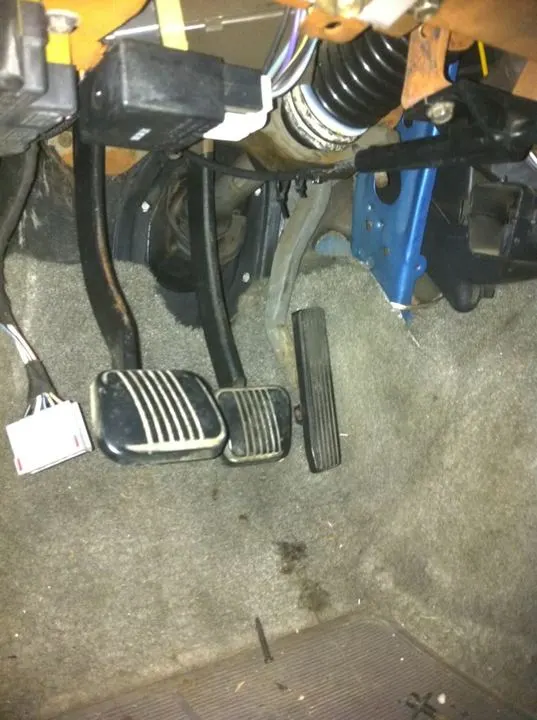

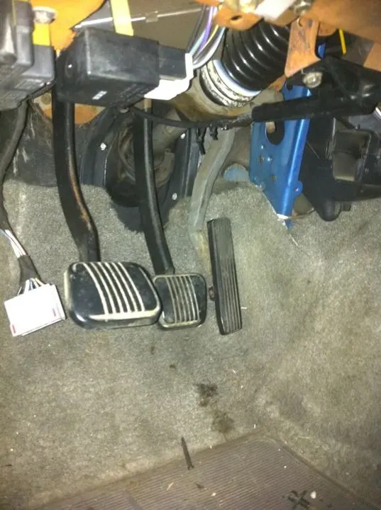

and heres a picture of the pedal issue. im gonna order an adjustable clutch cable that will hopefully help. but most adjustable cables specify GT or Cobra only. are there any, or will they work with the 2.3? and should i possibly just get a firewall adjuster?

use a FWA.The 5.0 cable isnt compatible with the 2.3 linkage. been there and done that with my last 2.3 t5 swap. I ended up using a stock 2.3 cable, FWA, and triple hook quad. I could have gotten away without the FWA, but it came with the quadrant so I used it to fine tune my pedal.
the engagement is fine, i just want to fine tune the pedal. so the FWA sounds perfect.
