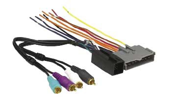

  2. Yea im sure yours works and im glad I found this thread, It just seems to (in my case at least) make more sense to use the 5510 being it has the 2 sets of RCA's (Front & Rear for the factory amps) which would work out just right with my Pioneer's Front & Rear rca outputs.

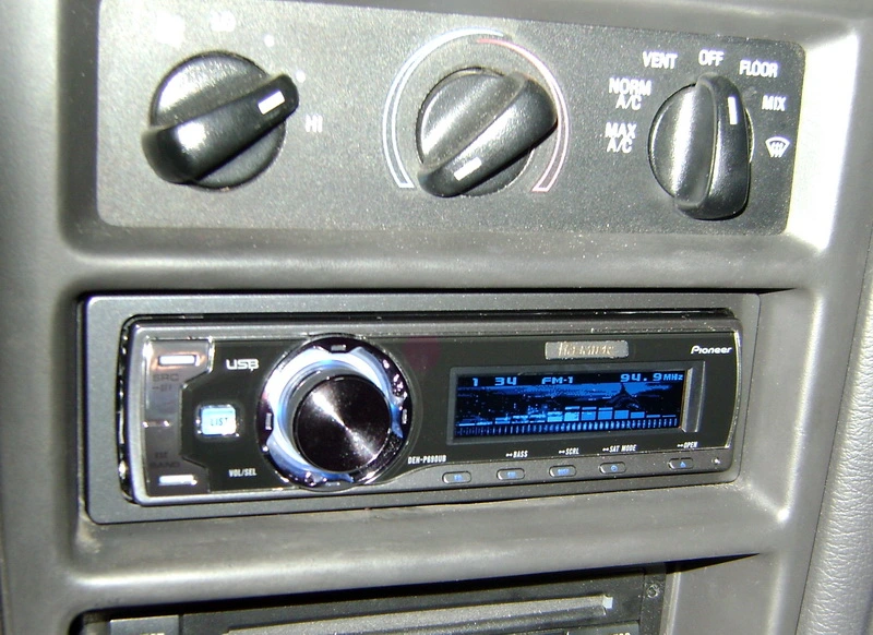

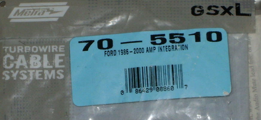

  3. The Metra 70-5510 kit finally arrived and it installed without any problems (2000 GT) however ill have to get a regulator as described in the tutorial because I get a bit of amplifier pop on power up.
    The stock deck was easy to remove with the ford removal tool but the cd deck is proving to be a real pain, we couldnt get it out after repeated attempts but for now ill leave it until I get a cubby.
    The Pioneer (model info) offers a lot more control over the sound vs. stock deck and it'l be even better once I get my JL subwoofer + amp installed.
    So basically the 70-5510 works fine with a 2000 GT + Mach 460 audio, just be sure to get a regulator to prevent amplifier pop.

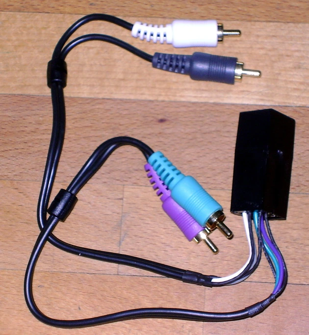

    (RCAs, part of the 70-5510 kit): I just plugged these into the Front & Rear RCA outputs on the Pioneer, so I didnt have to wire in the actual speaker wires located on the kit:

    My second question is if someone would kindly clarify the main differences between the two harness choices of 70-5510 and the 5511. As far as I can tell at least if has to do with rca adapters... does it mean with the 5510 there is less soldering? and that it is easier to install? more compatible?

  12. Okay, something is not quite right here. First, I have two small black connectors coming from the car, not one. One has 6 pins and the other has 8 pins. It appears as though both the 70-5510 and 70-5511 only have a connector for the 8 pin connector. What am I to do with that other connector, if anything?
    I have a 2000 GT with the Mach 460 setup.
    Second, now I think the 70-5510 is NOT the right harness. The pins don't line up correctly in the 8 pin connector; they are perpendicular to each other, assuming I try to use the fastener. I tried turning it, but they are off by just a little and forcing it in caused a couple of the pins to get pushed out. I'm likely going to break apart the harness so I can connect it and then tape it together so it says put before ordering something else. I'd still like to know how to connect that other connector.
    I'm using the resistor rather than the regulator. Once I get it working, I'll post how that performs. It is certainly easier to setup than the regulator... don't need to worry about ground.
  13. Alright, I figured it out. I cut the jacket around the pins off of the 8 pin connector on the harness so I could make the connection. Now it works fine.
    As far as the other 6 pin plug, I realized a little while after I posted the last message that the other plug is to connect the slave CD unit.
    The resistor works fine. I do hear a subtle pop when the unit powers on, but this is no different (from what I recall) than the noise I heard turning on the factory unit. Does the regulator eliminate the noise altogether? The resistor very simple to install.
