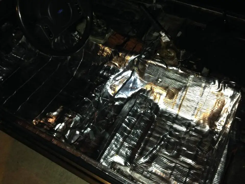

  1. Peel and sealed the drivers area. Not sure if it will help much but it can't hurt!
    Drivers door panel is done and mounted back in for good.

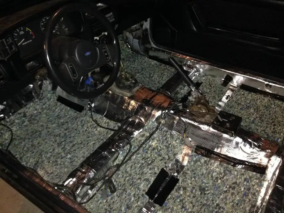

    With this in mind in embarking on a budget sound deadening set up. What you see is peel and seal for roofs going down first. In the photo I'm posting below you will see carpet padding. This is from a carpet store and was very cheap. It is not designed to deaden sound per say but to me it will help enough for what I'm looking for.
    Since this photo was taken the carpet is back in. Hard to tell at the moment, but the hollow sound the bare floor had before is drastically improved. Time to start putting the plastic parts back in and see if it really feels better.
    Another item I was able to test last night was the door work I did. The drivers side is done and the passenger side is as it has been for 10 years or so. Drivers got peel and seal on the panel and the door inner steel. 1/4" thick foam backing on the panel, and a poly vapor barrier over the door. I added some bracing where the arm rest screws went in (the old backer broke) and that about sums up the door work. The difference when shutting both doors is staggering. Hard to describe on the internet but the sound and feel is a huger improvement.

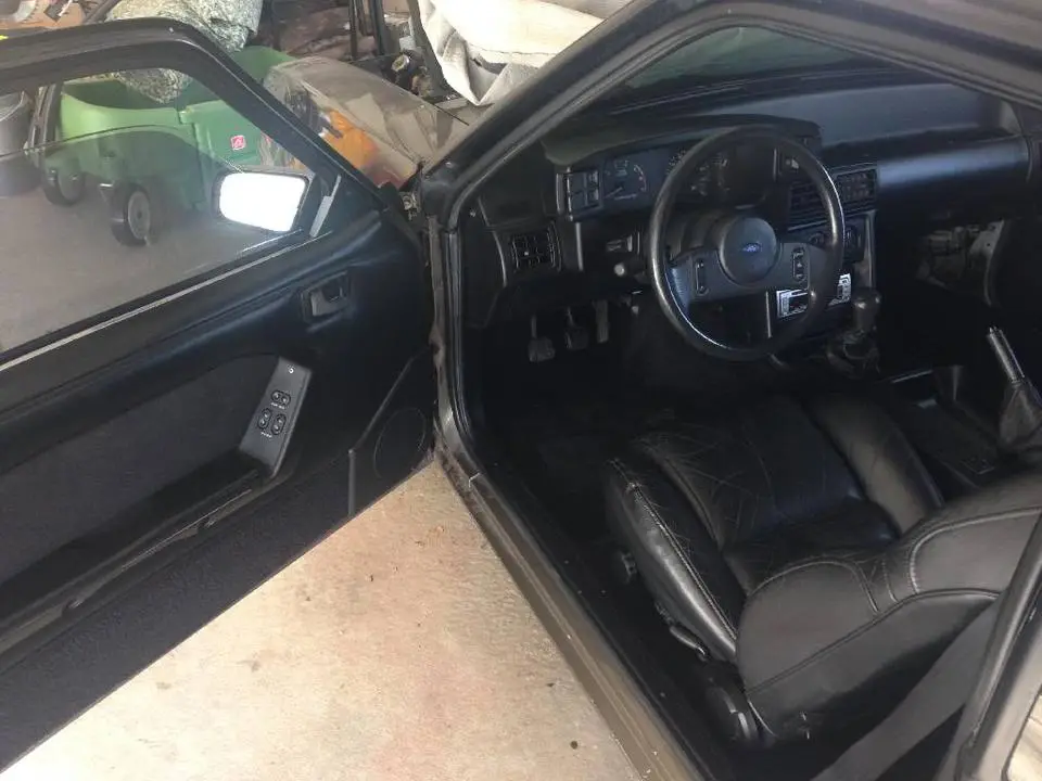

    Carpet is in. Center console is in. Drivers 1/4 panel has padding on the back and in place, just need to get the correct screws to hold it all in. Headliner got padding underneath and installed. Driver and windshield headliner trim and dome light in. Drivers seat is in, however I need one more bolt, and to work on the power to the seat. New black seat belt is in on the drivers side as well.
    Sitting in the car with this much done it feels more sound. Hard to describe it but it's just more comfortable feeling. I need to get the passenger side buttoned up, some more miscellaneous screws and hardware and then decide what to do for the rear seat. As much as I want to get a rear seat and reupholster it, I'm not sure I want to spend that money. I may create a quick rear seat delete with the black carpet I have.

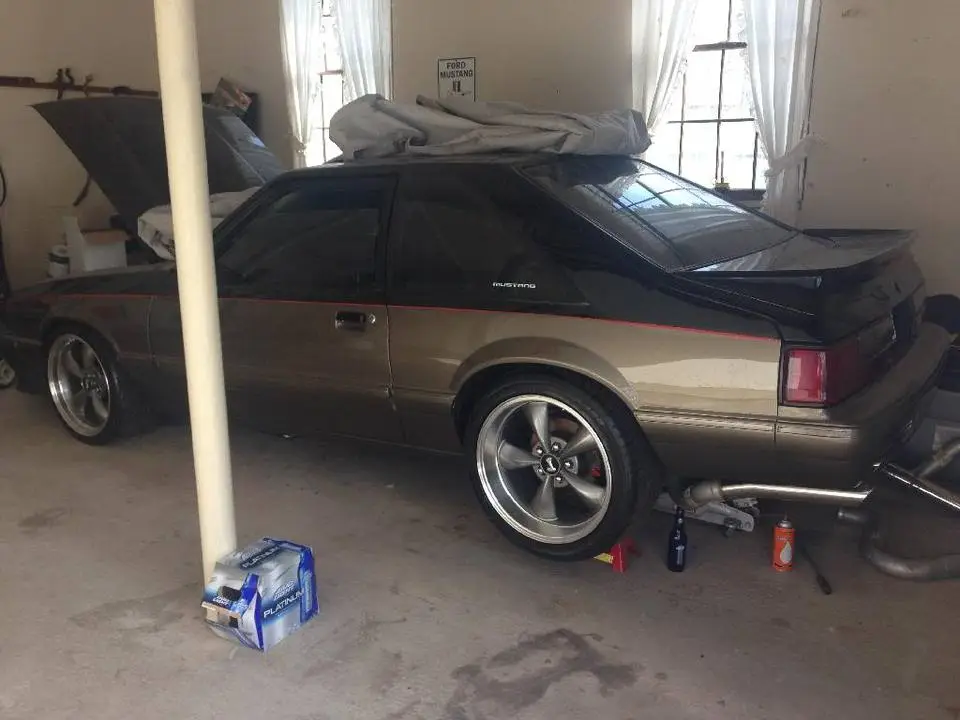

  20. As she sits now. Got the lower dash trim back in, which has not been in the car for 6+ years.
    Also started to mock up the tailpipes.
