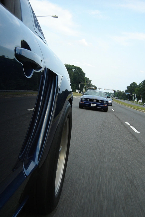

    I'm running 285/50 on 18x10 in the back.

    How did you take this picture? Just hang your arm and camera out the window?

    Yep! With my point and shoot Sony. I can only use my DSLR if I'm the co pilot...
