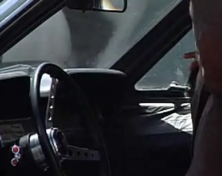

    Steve McQueen had Nardi steering wheels installed in the cars.

    The Bullitt cars did not have Nardi wheels. The wheel as featured in the film and selected by McQueen was the EFFPI wood wheel manufactured by F.I.V. in Milano, Italy identical to those on the 1967 Shelbys. McQueen had it covered in black leather.
    FWIW the period Nardi wheels are (IMO) of superior quality to the EFFPI wheel from F.I.V. notwithstanding the latter now selling for upwards of $2K (not that period Nardis are so much cheaper). You can determine a period Nardi as opposed to the modern era ones (in general) by its thinner rim and actually being manufactured in Italy as opposed to Spain. Most though not all Italy manufactured Nardi wheels are embossed with "Nardi Italy"

    Interesting. Up 'till now, every description I've seen of the Bullitt prep was Nardi. Perhaps the remaining car will surface from hiding some day.

    Yes it is a common well-repeated bit of misinformation (that the wheel is a Nardi). If you look at stills from the film (even the image you posted) you can discern details that match the F.I.V. steering wheel.
    Here is an article by noted Bullitt mustang expert Dave Kunz on how to build a replica that includes a description of the original steering wheel:
    http://www.ponysite.de/bullitthowto.htm
