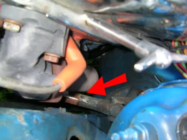

    Hi everybody, i just had to join the forum because i stumbled upon this thread when looking for engine swap stuff on google.
    I bought my 1974 stang after someone already did the engine and trannyswap, but what i didn't know was that there was some small (but anoying) problems i (still) have to work out to get it through swedish inspections.
    My biggest dilemma is that the exhaustpipe connected to the original ford exhaust manifold, shafes against the steering column (see picture).
    My question is: What type of headers did you guys use on your engineswaps?
    Can you recomend blockhuggers? And would i have to tinker with my enginemounts to get those to fit?
    Heres my baby in its present condition: http://www.metasyntactic.se/mustang

    Laslo, V8 blockhuggers will not work with the crossmember in a Mustang II. You will need to use Hooker or Hedmann headers. I bought my Hedmanns for around $150 from Summit. I am surprised to see that the pipe interferes with the steering column; I've never seen that before. It makes me wonder if your exhaust manifolds are not stock. The manifolds were specific to the V8 Mustang II.

    Naw, those are probably not from any stang.
    More likely they are from a galaxy or something like that, not sure actually :)
    Do you have any part numbers on the headers you got, i would appreciate it.

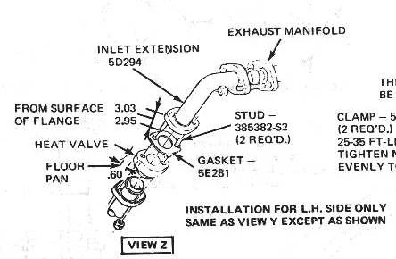

    The stock exhaust had an extension on the left side with a flat spot for clearance where it passed by the steering column. Here's a detail of the extension piece, but the flat spot is not visible here:

    Yeah, I did the V-8 swap in my 74 last year and i had the original manifolds on and there was NO issue at all with the steering. My recamendation on headers would be the hookers.
