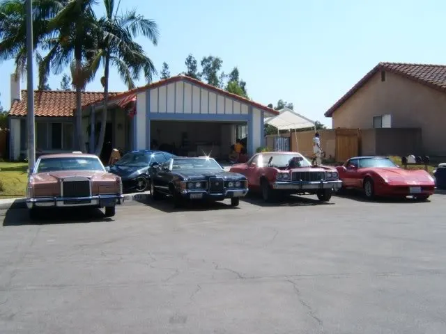

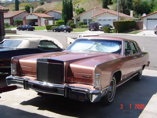

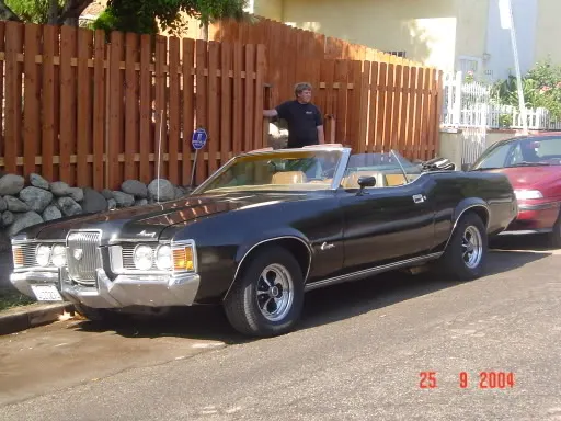

My other Fords:
72 Cougar XR7 vert 351C
79 Lincoln Continental 400
75 Ranchero GT 429 SCJ

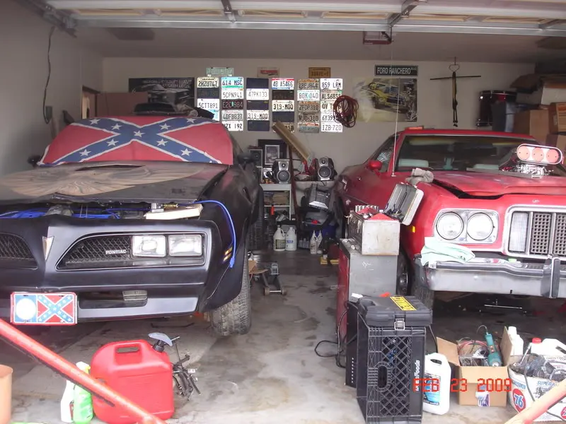

Nice collection! My wife would kill me if I tried to have that many cars... That was the best year for the Trans Am, IMHO. Tell me it has t-tops and a 4 speed and I'll *really* be jealous.

hahahahahaha.....right you are and it has the Hurst t-tops (believed to be only 400 made using Hurst and it switched over to Fisher) It's the black special edition model. Bought it in 1980. She's pretty much well used though. Recently, I had the 400 stroked to a 467 by
Speed-O-Motive. They've been around since 1945 building race motors.
