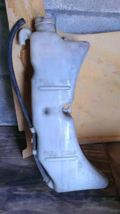

    Another thing I wanted to mention is the overfill tank. It's super dirty. I dont see dirty water in the radiator cap, or when I changed the thermo, but that overfill plastic tank is super nasty. The tube with sensor is pretty bad. I wipe it off usually when I pull it out everytime but is this dirty because everything is plastic and it's attracting all the dirt and therefore keeping it out of the engine?

    The system was pretty dirty. I think it was just build up in the water overflow tank. It did smell a little bit like oil but I really couldn't tell.
    Cleaned this out with a brush and bleach cleaner:

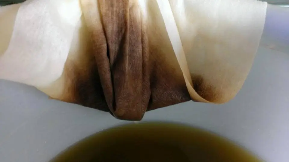

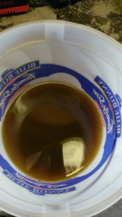

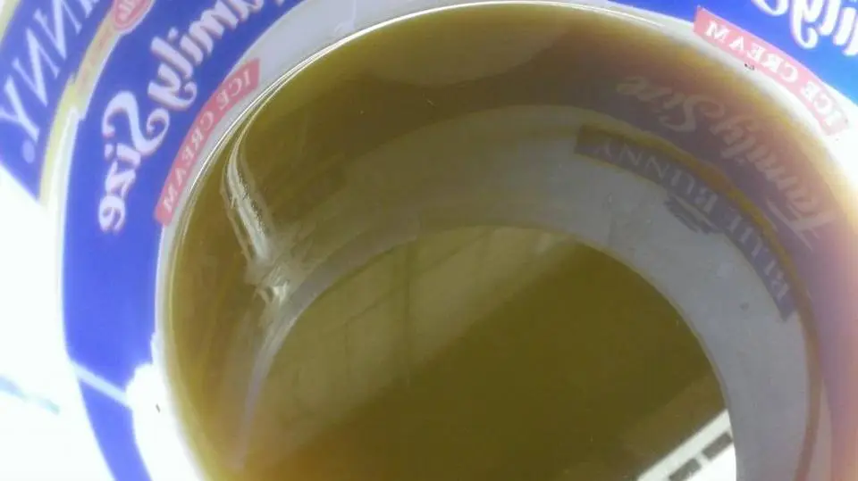

    Here is what the water looked like coming out of the overflow tank:

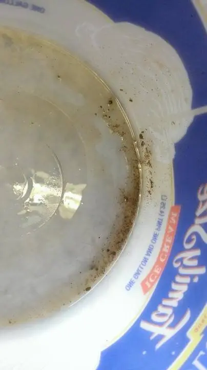

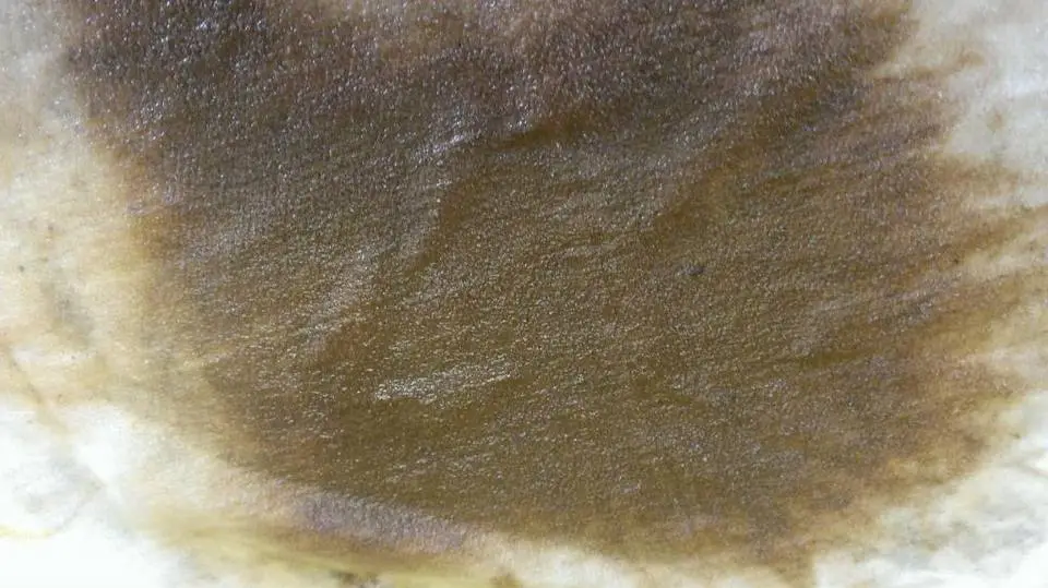

    This is the paper towel I used to strain the water to look for large particles and oil residue:
    Large particles weren't bad:

    I looked at the overflow container and it was at the "FULL WHEN HOT" line. Radiator wasn't plum full but it wasn't missing too much water either. Is this a air pocket issue I have going on?
    Also, I reached down to the radiator cap and smelled and it smells like oil to me but again, not sure if its really just older smell with antifreeze. I don't know. Should it have a small trace of oil smell to it? Is this normal to kinda smell like oil?
    The water in the overflow is still really really clear. When I cleaned it out and filled the system back up with antifreeze I only put water back into the overfill container. It looks as though the new cap is working well but not letting any antifreeze from the radiator move into the overfill and visa versa. This would be a problem right? I read that the 89 mustang is a pressured system. So when you are running low on coolant you only fill the overflow as when the temp rises it floods water into the overfill tank, then when it cools it draws water back into the radiator.
