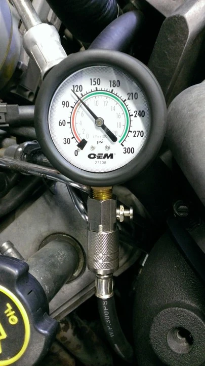

  1. Ok guys, it's been a while so you may need to go back to page 1 of this post and look at my progress but I started looking at my car again this weekend.
    I rented a compression tester from autozone and tested all my cylinders. They all went up to 110 PSI and stayed there for 2 minutes no drop in pressure. This makes me thing there is no head gasket problem now...
    I am at a loss. Why am I still losing antifreeze via the overflow? Is there a way to test my radiator for functional problems? Is there something else I should test?

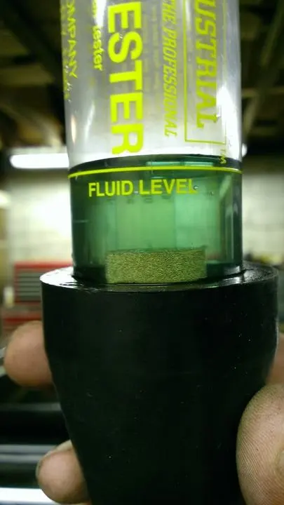

  7. Well my biggest fears came to life last night. I rented the OEM/Block tester from autozone and ran a couple tests last night.
    First the liquid was blue:
    Then the liquid was Green/Yellow
    The green in my second test actually turned more yellowish than what you see in the picture. It almost immediately started to turn from blue to clear(is what I thought). and when I held it up to the light I realized that was the yellow they said it will turn. So I have emission gases leaking into my coolant as I suspected. Thanks to all who helped me get to this point. I sure wish I knew that kit existed from the beginning and how cheap it was. I would have ran that test from the beginning!

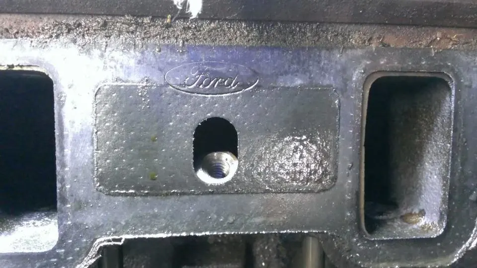

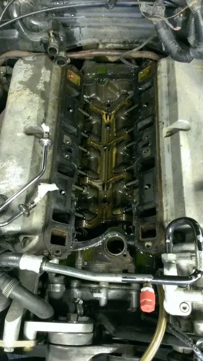

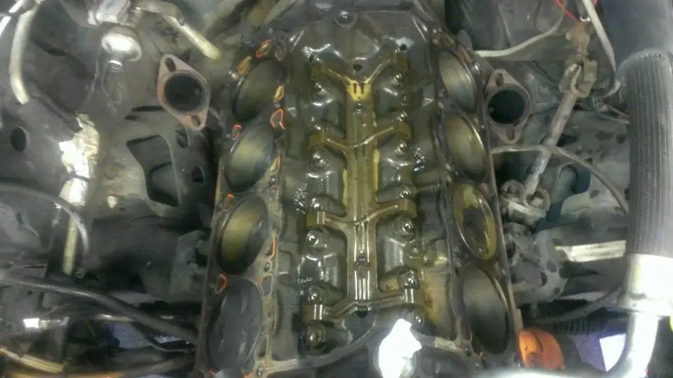

  13. Made some progress last night. Got all the way down to the heads.
    Upper and Lower intake off:
    I was very happy to see this logo on the seals:

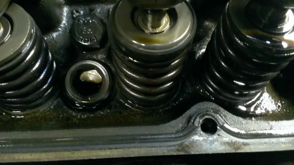

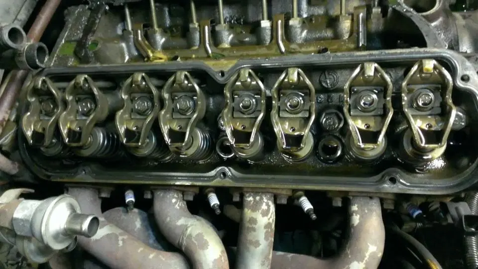

    So I took out the rockers and pins, took out the 5 bolts in middle of head, 2 bolts on each end of head, and I have the headers unbolted at the flange. I also disconnected the vacume tube on back of both heads. I still couldn't get the heads to budge?? :scratch: What am I missing?
    Here is a close-up of the heads, there are 3 large socket head screws in middle of heads, do they need to come out too?
  14. You have 5-lower head bolts also.....look down next near the spark plugs, you'll see them. ;)

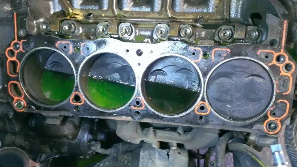

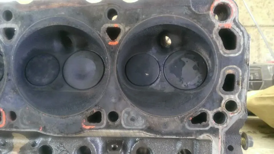

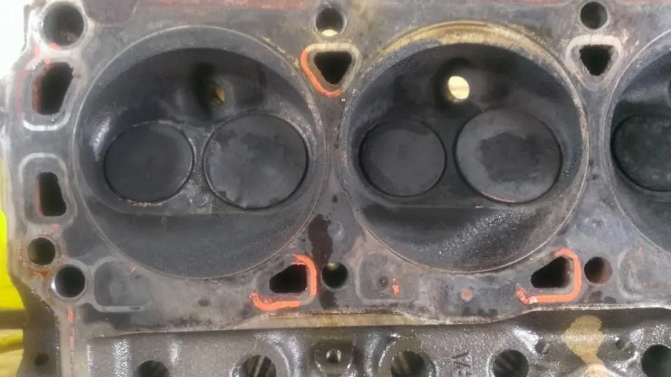

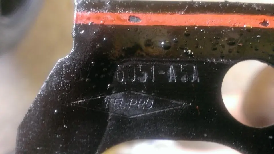

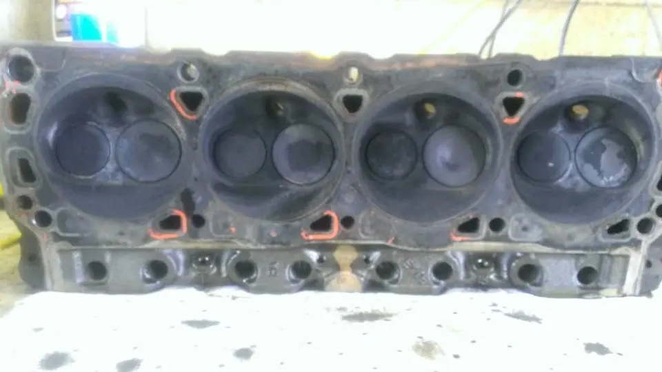

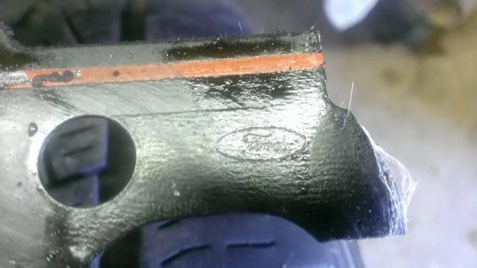

  15. Found those bolts. Got everything apart. Heads off. Gaskets all scraped off and cleaned up. Taking heads to the machine shop today.
    I didn't see anything wrong with my gaskets... Matter of fact they looked to be in great shape. Pretty awesome to see the ford impression on all of them. Just lets me know nobody has been inside this engine before and it truely only had 23,000 original miles on her.
    So. I didn't see any cracks in the heads or the block. How in the heck did that blue water turn green and I not find any issues? Wouldn't I see a crack somewhere? Or a bad gasket tear?
    Here are some pics:
    I didn't know Fel-Pro made gaskets for Ford right out of the factory!!

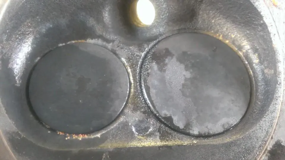

  16. can you guys tell me from my last pictures of heads and cylinders if I have a problem? Both the heads and cylinders tops had that black carbon on them. Is that because they are running rich or do I have an issue?
  17. Probably just carboned up from a lot of short trips. get a flash light into the exhaust port and see if the valve are covered with any excessive carbon. I remember pulling down my '87 a few years back and the valves were just caked with the stuff. While you've got the head off, check your crossover tube bolted to the rear of the heads that is fed by the pollution pump....assuming of course you still have your emission system installed. They have a tendency to plug up with carbon.
    If you're taking the heads into the machine shop to have them planed, it wouldn't be a bad idea to give them a fresh valve job and new seals. Even if the mileage is low, the engine is 20+ years old. Valve and valve seats pit and seals go hard over time.
  18. I'm having them pressure tested. I can't figure out why there are emission gases in my coolant system if the gaskets and heads look fine... I'm at a loss so I'm having them pressure tested and checked for warping. If they find nothing wrong with them I'm sunk. My troubleshooting experience will be at a halt as I don't know what else it could be.
