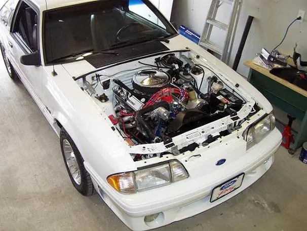

    I was wondering if anyone on here has tried 90/10 front shocks on the street with their Fox Mustang.
    I've got Competition Engineering adjustable rears.
    The car is no daily driver, but I DO drive it on the street. I had some serious traction issues last summer at the track and am thinking about a set of front shocks. I've been warned the 90/10's are a bit of a chore on the street.
