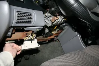

    mustang 003.jpg I have a 95 gt. The guy I bought it from broke the ignition key cylinder but thats alright cause I want to put a push button start in anyway. I have everything I need exept I can't find a wiring diagram for the ignition switch anywhere ? I want to wire everything on toggle switches + push button (momentary switch) for the starter. Also since buying the car I've talked to a lot of experienced mustang mechanics and they say the 94/95 GT's are the hardest to get more power out of . Is this true and why ??? Any help with this would be great.coreymack27@yahoo.com mustang 002.jpg

    For the starter it should be easier to go straight to the starter and wire it from there.....Well at least for me it was....and I think its just harder to tune the 94-95 than it would be a fox....
