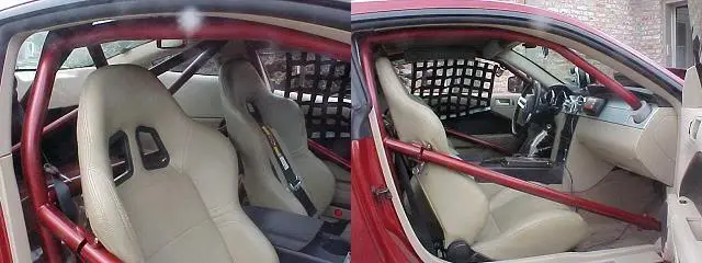

    It is a bit silly to start gutting such a nice car, for the odd track outing. However, if you insist upon deleting the a/c, install a full cage and run it through the outer a/c vents like we did. That way you can make sure to destroy the interior...lol. While you're at it, delete the nice sound system for more weight savings. Don't forget to move the battery into the trunk, but you will need to add a kill switch on the rear most portion of the car.
    +1
    Unless removing a/c is part of a bigger plan to lose 200-300lbs or more, deleting the a/c alone will not likely yield lower ETs
