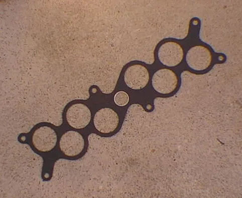

  4. SN95StangMan New Member
    Member Since:
    Jul 5, 2003
    Message Count:
    1,321
    Likes Received:
    Trophy Points:
    You will also need to purchase the upper to lower intake gasket for the GT40 intake separately.
    Looks like this
    [IMG]
  5. SN95StangMan New Member
    Member Since:
    Jul 5, 2003
    Message Count:
    1,321
    Likes Received:
    Trophy Points:
    I'm not sure he wasnt talking about the 1250's, which are most recommended here
    [IMG]
    only problem with these is that they come with the crappy cork ends as opposed to the rubber ends that the parts store units come with.
    Also, you need to trim around the water ports.
    Both sets will do a good job, IF installed properly

    The 1250s are for ported heads. You don't need them for a GT-40 intake, it's just a waste of money. On top of having those crappy cork ends.
    Kurt
