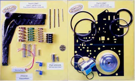

    KIT 1:
    #8. AODE / 4R70W Fairbanks high performance TransAction kit. Fits 1991 to 2002. This TransAction kit includes a newly designed OD servo piston and a no leak performance design 2-3 accumulator piston. Includes steel boost valve and sleeve to replace worn OEM. This is the same kit we use in the Interceptor transmissions. Cost $118.00
    Offers 3 levels of Performance:
    1. Heavy Duty
    2. Street & Strip
    3. Full Competition
    [IMG]
    KIT 2:

    As best as I can tell, all the parts found in kit 2 can be found in kit 1 with other stuff.

    ok kool thanks, does it look like a decent kit? ie has anybody used it before?

    As best as I can tell, that kit looks good to go. Just remember what I said about line pressure and blocker rings. If the kit has any blocker rings, throw them out, you won't need them. If it asks you do anything to the line pressure in anway don't do it.
