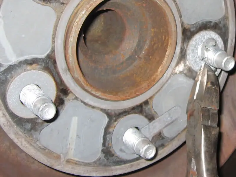

    Here is the brake retaining washer...
    [IMG]

    FYI, the retainer nuts (little metal clip washers) on the wheel studs are used so the brake disc does not fall off during factory assembly. Ford instructions say to remove them when you take the disc of for maintenance and do not require them to be reinstalled. Taking them off will not cause any damage or harm.
