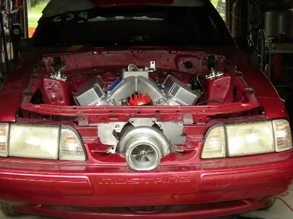

    u can do it with a sbf but i just wanted something different than all other mustangs. i had a A block,A heads,billet crank,billet rods,danny b belt drive and i had alot of money in that motor u can do it alot easier with a 460 than a 429 because alot of parts are going to have to be custom because of the deck hieght.
    i started off as a 547 with a 101 mm turbo but im going back to a 427 that will run high to mid 9s on motor
