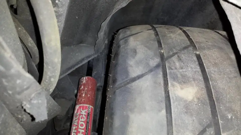

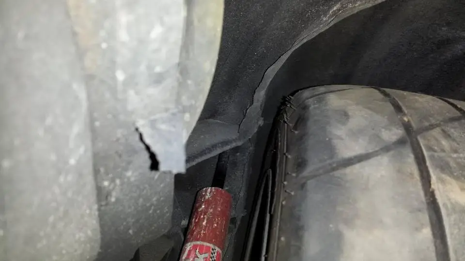

  1. Hey guys I was wondering exactly what you had to do to get them to fit. Or did you have to do anything at all. Please post pics of the inner wheel wells with and without the wheels on if possible. My buddy just test fitted his 10.5" 03 Cobra rims on his 93 notch that he just bought and they fit. I took some pics but I can't tell if the inner wheel well was messaged or not. The inner fender lip was rolled and quad shock was removed.
    Can you guys tell if these inner wheel wells were messaged or not?
    I'm just trying to see what I'll be in for if I try to put 315s on mine. Thanks in advance.

  2. are those nittos? they run narrow.
  3. I am running that combo. Pics wont do you any good. You will do a lot of pounding and rolling. Every car sits differently so every car will need adjusting in different places.

  5. No they are Mickey Thompson DRs 315-35-17. I guess the work was already done to this car by the PO. My buddy just bought the roller a couple months ago and he's doing a Terminator/T56 swap. It already has 5-lug conversion, 4-wheel disc, tubular k-member, etc.
    krazedstang likes this.
  6. nice you have plenty of room
  7. That's what's making me think the PO did all the work to make a wide rim/tire fit. I'm more than sure I won't be so lucky with mine. But I will see when I get my rearend done next month.
