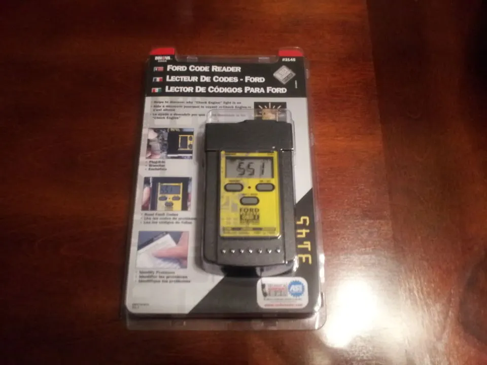

  6. The code scanner I just ordered was the Innova 3145. I got it from Summit Racing and it was about $27 shipped. Its nice since it actually reads and displays the codes instead of trying to count how many times the CEL blinks.
  7. Pulling codes only takes a few minutes so, if there is an issue you want to see if the PCM has picked up on a sensor reading that fell out of spec. It's a valuable diagnostic tool every 94-95 mustang owner should own.
  8. Thanks Toyman, yes I am grabbing one this weekend.
  9. All autozone had was the ones with the blinking light. So I ordered the one Jdubz did from summit. Jdubz how is yours working for you?
  10. Mine worked very good. Very easy to use and its nice since it stores the codes on it until you run the test again. But since I got really impatient waiting for it to arrive, I actually got really good at counting the blinking CELs and got the same codes. But it is a must have if you are trying to diagnose a CEL, especially if you have a lot of codes.
  11. I got the same one. Mine came alarmingly fast too.. haha. Thanks for the input
