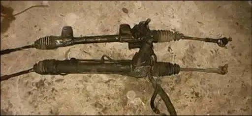

The proper front sump 351W oil pan clears a manual rack fine, but gets too close to the power steering rack. My '78 has manual steering and the big Milodon pan with plenty of clearance, but my '76 has power steering and a normal front sump 351W pan and a piece of paper would be lucky to slip between the rack and the pan.

parthos, any idea if that's with power steering? cause like a351mustii was saying, the pans work fine with the manual racks, but power racks are not as easy.

I dunno about the steering rack, I have a power one, that currently has no power, it leaked so now it has armstrong steering. I think the power rack may be bigger, someone who has both could perhaps take some measurements.
digging deep.................
