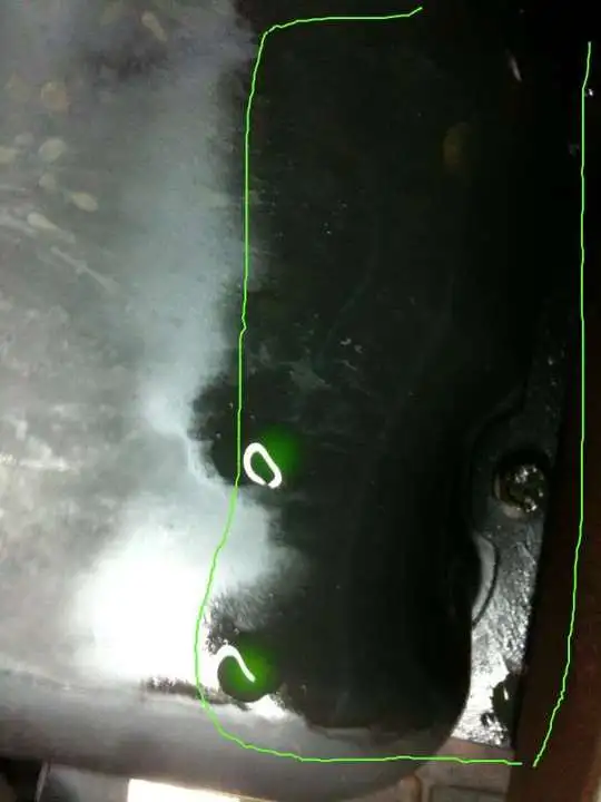

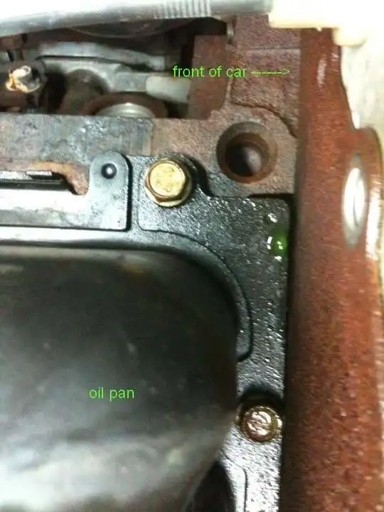

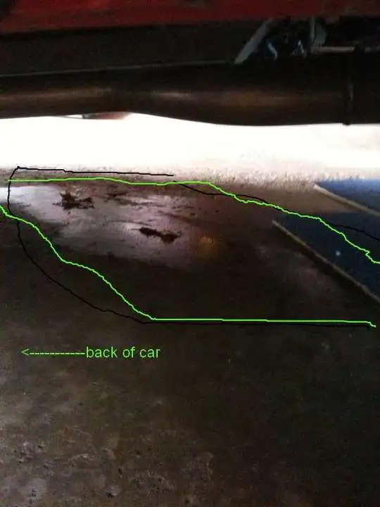

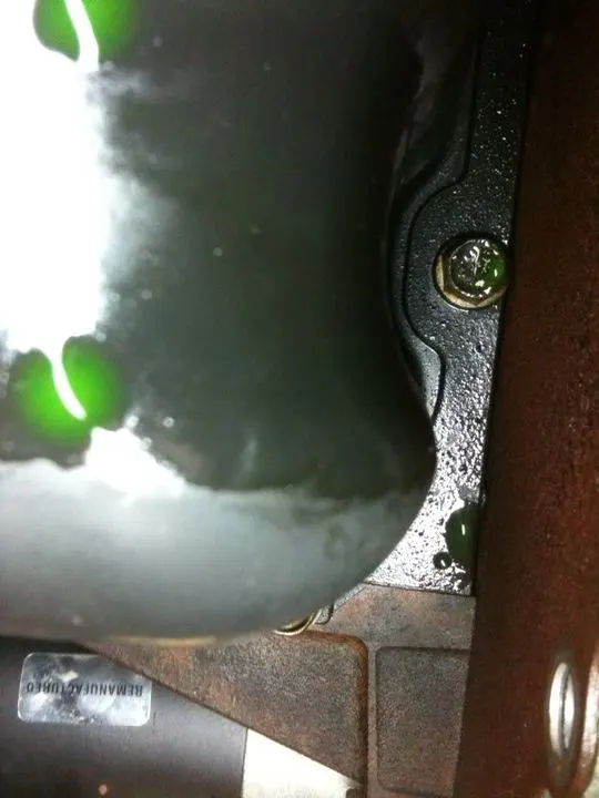

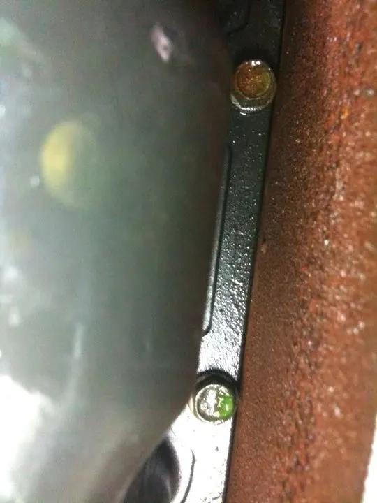

Well, went in the garage last night only to find this.... since it has been up on ramps, more coolant started leaking. Got under the car again and it is all around the front of the oil pan. This is the ONLY place I can find any signs of coolant. All these pics are me laying on the ground looking up. Also, the overflow is not almost completely empty, before, the coolant would stay where it was at.
jeebus...im so sorry you havent been able to track down this issue since the car was on ramps..would it be safe to assume that the leak is from the rear of the block? no sign of leaking at the firewall into the heatercore? ---for clarification....now its is NOT spilling over at the reservoir like in your original posts?
Thats what I was leaning towards. None that I can see. Its seems to be at only whats in the pics. Of course I didnt tear into anything. Just trying to see something without having to remove anything. It does that when the car is runnin, within minutes. When I first posted this, there was no signs of leaking anywhere. No there are, and last week was just a little, now thats its up on ramps, there is alot. Also, when the car was sitting on the ground, the coolant in the reservoir would stay where ever it was at. Now on ramps, it drained and is almost empty now.
